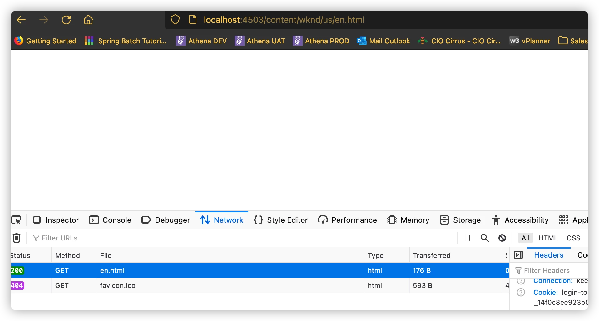

I published the changes in author, but  can't see anything in local publish environment. Any suggestion? Thanks
And when I try to check http://localhost:4503/content/wknd/us/en.html, it's a blank page

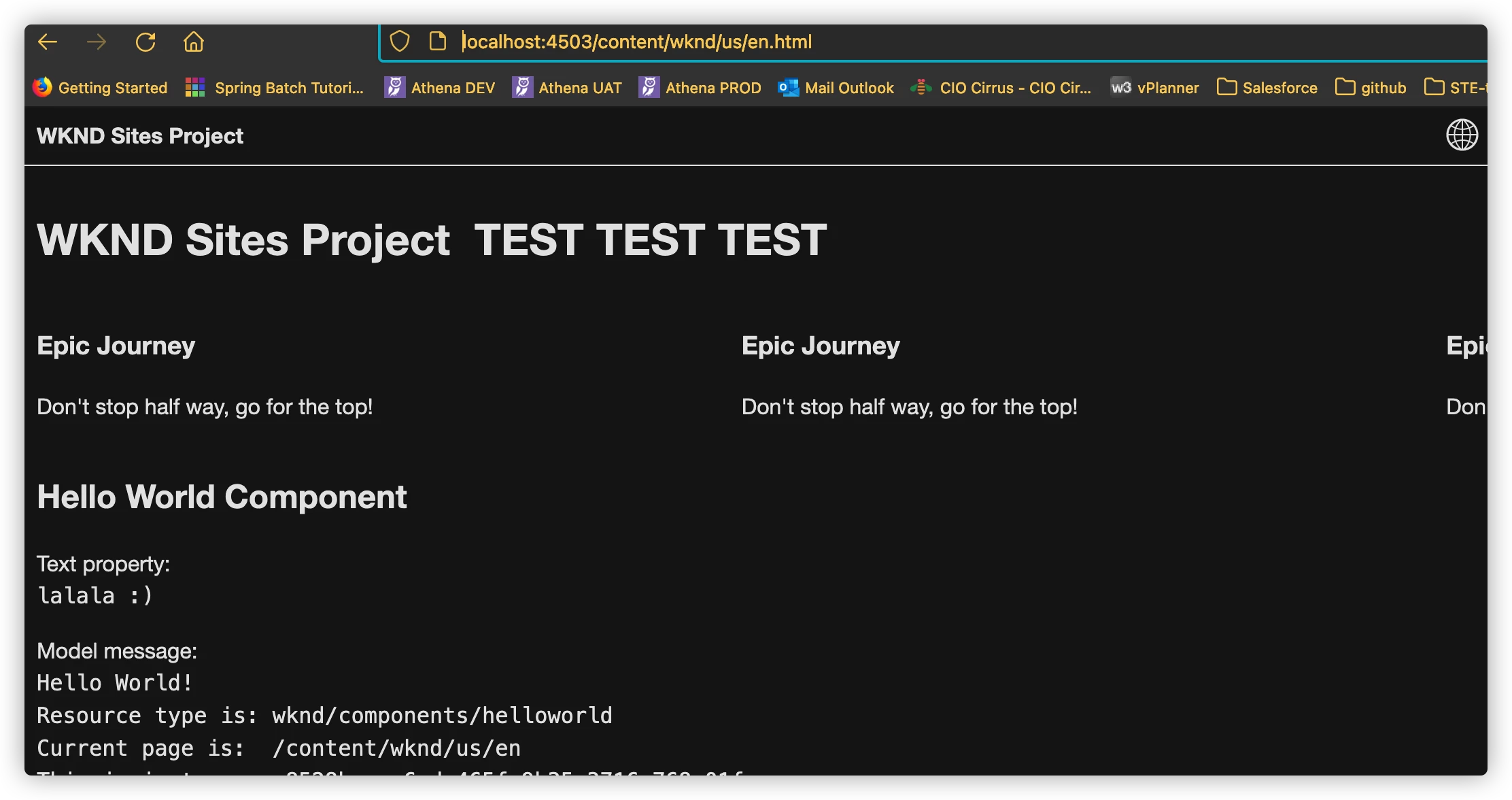

@kishore_kumar_Thank you.
Now I can see the content with URL

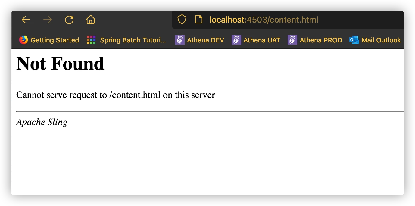

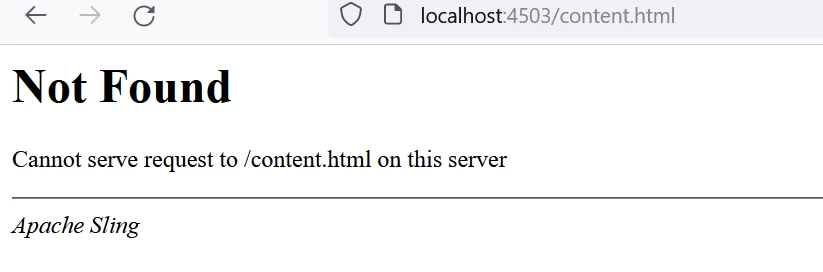

But I can't see the content directly with URL http://localhost:4503/
Any more suggestion? thanks

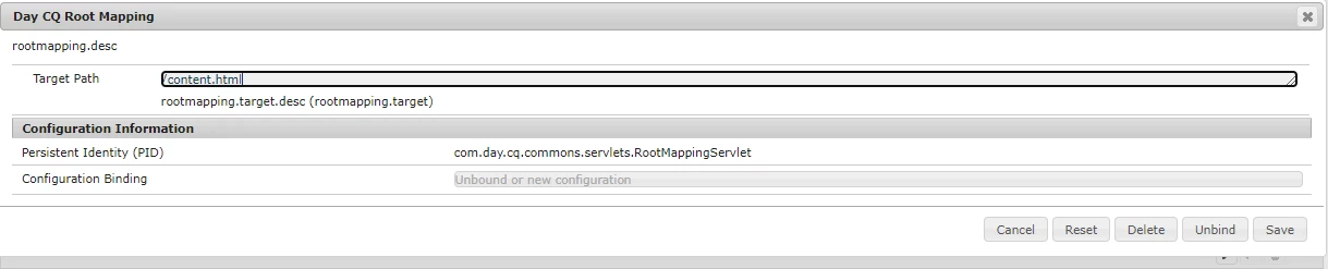

We have to do mapping configs for redirects. Please refer below article to get some idea.
https://www.albinsblog.com/2020/07/configure-sling-mapping-for-resource-resolution-in-adobe-experience-manager.html
and JFYI the reason you are redirecting to localhost:4503/content.html if you hit localhot:4503 is due to config of default root mapping of publisher.
Go to
http://localhost:4503/system/console/configMgr
check for "Day CQ Root Mapping" property.
Similarly for author instance if you hit localhost:4502 it will redirect to localhot:4502/aem/start.html

@wkk52586 one quick question, did you also deploy the code to publisher instance?
In order to see the page content on publisher, make sure both author & publisher has same code based installed.

Hi @wkk52586
What is the error thats coming in the logs?
Can you confirm if the same page is working in author?
Can you confirm if all the bundles are installed and active in publisher?

@kiran_vedantam  @siva_sogalapalli  I'm a green hand for AEM. After installing the author and publish and run them up. Setup the configuration and test successfully.
Then I just followed the guide in https://experienceleague.adobe.com/docs/experience-manager-learn/getting-started-wknd-tutorial-develop/project-archetype/project-setup.html?lang=en
Generated the project and ran the command
mvn clean install -PautoInstallSinglePackage
The WKND projects deployed to local author:
Then I made some changes for en and publish that,
But in local publisher ,it's a blank page
Any suggestion? Thank you!

Hi @wkk52586
Run below command to deploy in publisher instance and then check please.
mvn clean install -PautoInstallPackagePublish
