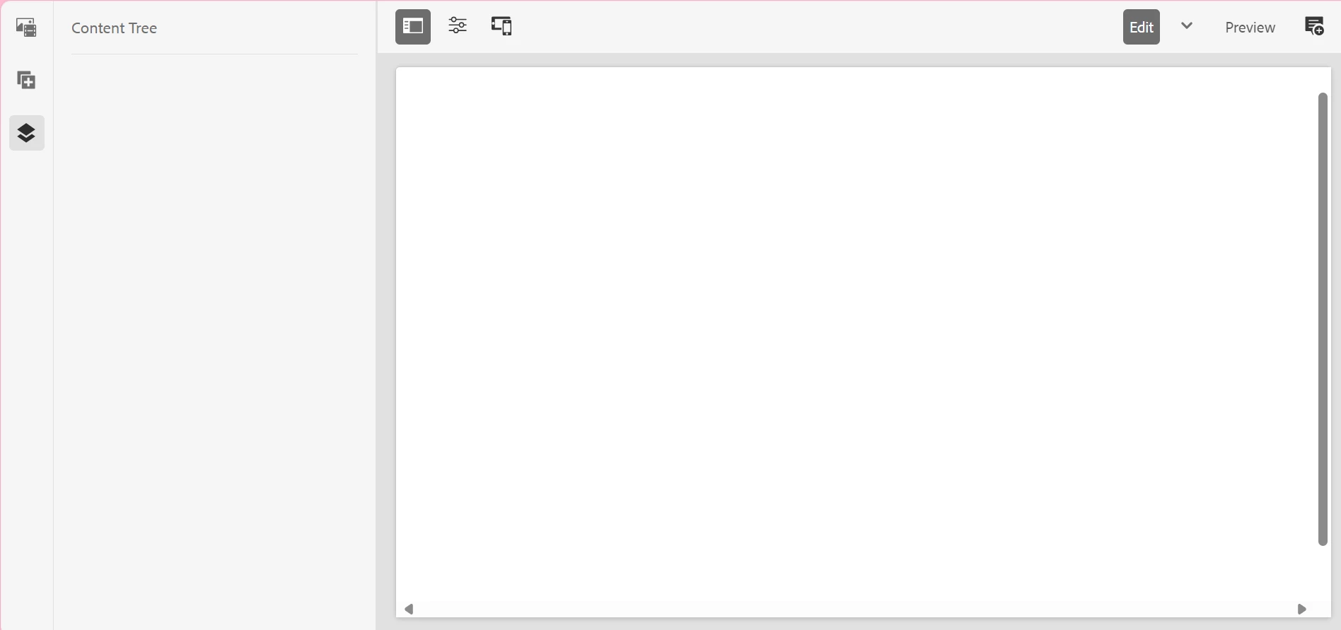

I am working on an issue that needed me to install SDK version 2024.10.18311 locally and ensure I get a successful build with no issues. I’ve done it and the build was successful.
I also got the necessary org.apache.jackrabbit.oak.commons;version="2.2.0", but upon testing my local content, no components and contents are displayed despite successfully installing it via Package Manager. Pages and assets are present, but no components. Please help. Any documentation or solutions will be appreciated.

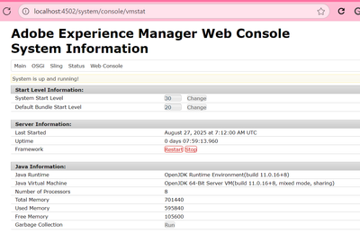

@winter_bunny can you please check which Java version you are using ? and also it depends on which java version it was using when you installed SDK,. you can check the java version its running with this url
http://localhost:4502/system/console/vmstat
August 27, 2025
I'm using IntelliJ and I am using Java 11:
