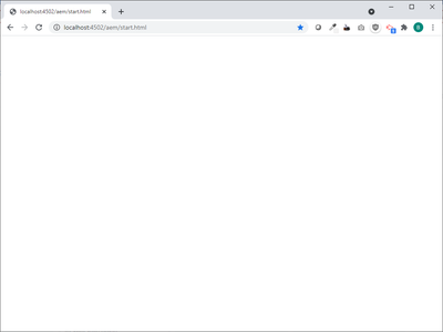

My local AEM instance has been working fine, but suddenly won't start. I restarted Docker, restarted my PC, updated and restarted Docker again, but I get HTTP ERROR 500:
localhost is currently unable to handle this request.
HTTP ERROR 500
I have Docker v20.10.5 running with aemdesign/aem started. CRXDE Lite opens but it's blank. Any ideas on what could be the cause?

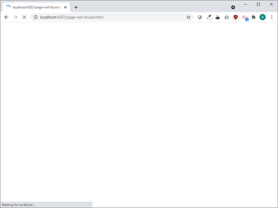

I have this URL bookmarked, which I've always been able to access, but now I get a blank screen:
I navigated to http://localhost:4502/system/console/status-slingsettings
But I get page not found when I go to http://localhost:4502/aem/crx-quickstart/

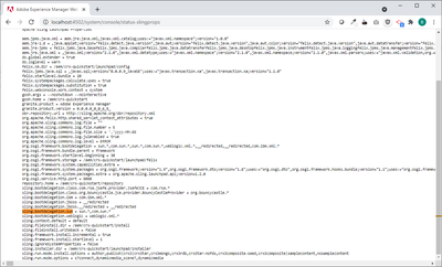

I found this:
What's the recommended way to edit this file?
Asutosh_Jena_
May 4, 2021
Do you know where the AEM jar file is present. How are you starting the instance? You need to look for sling.properties file in the file system.
