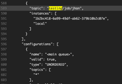

{ "topic": "midnight/job/categories", "instances": [ "33f32c32-5bd5-4fcb-b2a2------------", "local" ] },

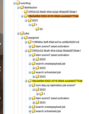

I can see the job has an instance assigned  but on crx
So no idea why the consumer is not being triggered

I have a consumer just for a test and the same case here never happens on the cloud if I tried on my local works fine
@Component(service= JobConsumer.class,
immediate = true,
property= {
JobConsumer.PROPERTY_TOPICS + "=testing/job/jhon"
public class TestingConsumer implements JobConsumer {
private static final Logger log = LoggerFactory.getLogger(TestingConsumer.class);
public JobResult process(final Job job){
log.info("Testing Scheduler Consumer is now running");
log.info("Time {}", Calendar.getInstance().getTime());
return JobResult.OK;

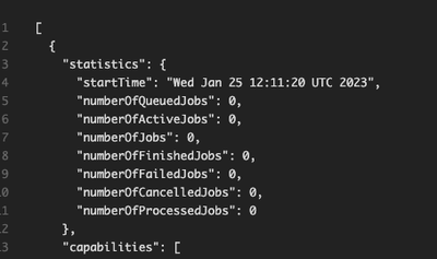

 Also, I found some logs that maybe are related, as this is a cloud I'm not able to see if the bundle is being affected or how is this being affecting others bundles
[{"name": "All bundles are up", "pid": "org.apache.felix.hc.generalchecks.BundlesStartedCheck~systemready", "message": ["TEMPORARILY_UNAVAILABLE Inactive bundle 0 org.apache.felix.framework: STARTING, "INFO --- unsatisfied ref jobManager interface org.apache.sling.event.jobs.JobManager ","INFO --- Component org.apache.sling.event.impl.jobs.JobManagerImpl satisfied","INFO --- unsatisfied ref workflowBucketManager interface com.adobe.granite.workflow.core.jcr.WorkflowBucketManager ",

This is all I have access to on Cloud, sadly I cannot see the bundles or configurations as we see on previous versions of AEM
I can see here there are no scheduled jobs but on local, I can see nodes on that node
