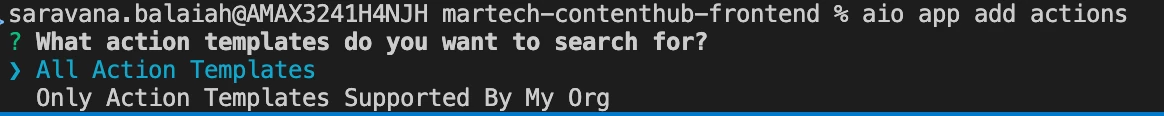

Does the add action wizard load successfully for you? this is the wizard sequence for me
after selecting all action templates, I chose generator-add-action-generic similar to you.
and provided action name. I tried add action from node22 as well and works.

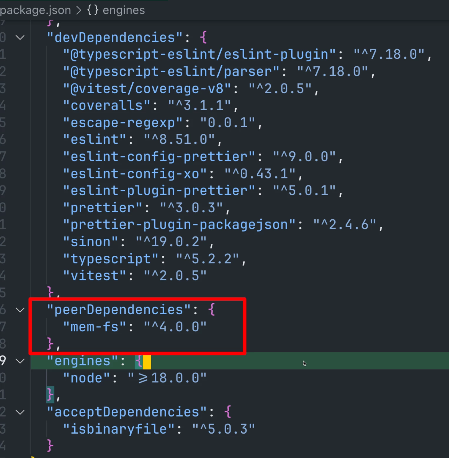

sarav_prakash
February 24, 2025
is this 'mem-fs' dependency, part of your code? is it in your package.json or just loaded by some dependency?
coz 2 months back same issue was reported and suggested to move the dependency to peer dependency.
https://github.com/yeoman/yo/issues/803#issuecomment-2552635393
worth a try if you are only adding mem-fs to your dependencies.
