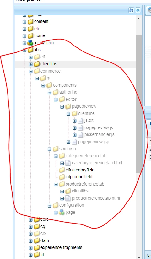

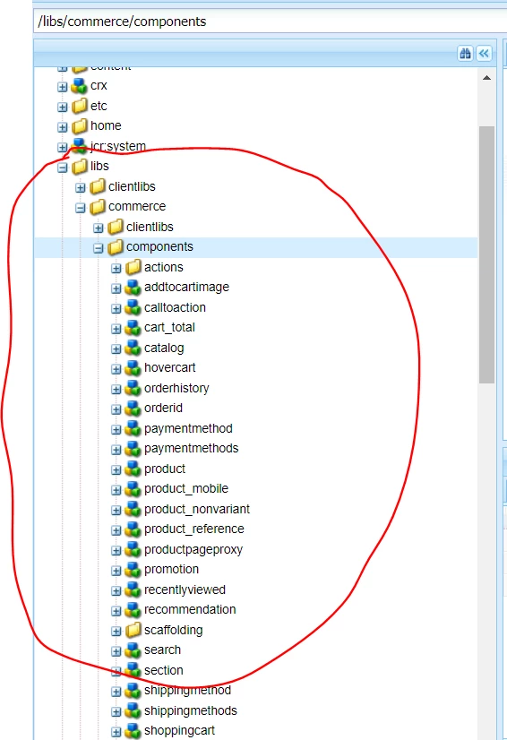

I am migration from AEM6.5 project to AEM as a cloud manager and while analysis I found that below commerce component are not available in AEM as a cloud
  1. /libs/commerce
  2. /libs/commerce/component/product
  3. /libs/commerce/component/...other component
AEM6.4
AEM as as cloud + CIF :  I also in installed CIF .far file on my local but still not found those component.
In AEM6.4 we my project heavily dependent on those component, Can you help me where I can find those component or do I need to install any other add-on package on AEM as a cloud.

Hi @codingstar,
According to official documentation Commerce components that you are using in your project has been deprecated since AEM 6.5 - Adobe was recommending to use CIF Core Components instead. In AEM as a Cloud Services deprecated Commerce components have been removed and will not be available again.
Base on migration documentation, you have to switch to different approach, that use:
Summarizing, to solve the issue, you have to re-implement your solution to use AEM CIF Core Components.
