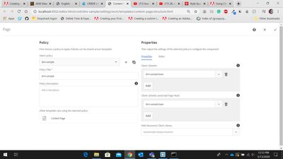

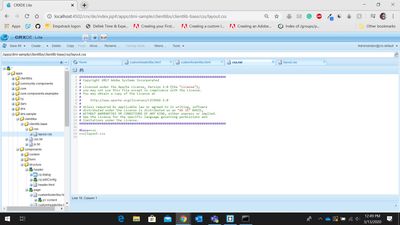

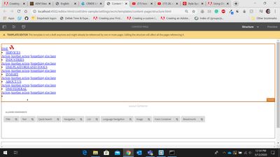

I am currently facing some issues while applying custom CSS to the template. When I am trying to apply styles from the page policy no style is visible and it seems that no CSS is applied. I am also attaching the screenshots of the files and issue.Css.txt fileCss.txt filelayout.css filelayout.css file
page policypage policy
templatetemplate

In your css.txt file, you have written
#base=css
css/layout.css
which is totally wrong. this should be written as
#base=css
layout.css
or
just css/layout.css
because #base property denotes the root folder.
Note. you also have to update your clientlib category name inside your page templates component
e.g. /components/structure/page/headlibs.html

Thank you for being very clear with your problem by providing screenshots of your configuration. Your setup is 100% correct. The editable template is configured correctly, corresponding to the "dmi-sample.base", client library.

Thanks for the response, by following your steps it is showing the background colour as required, font colour as required but other properties like text-decoration, display and may other properties are still not applied. Can you please tell me a bit more about it as to why is this happening?
