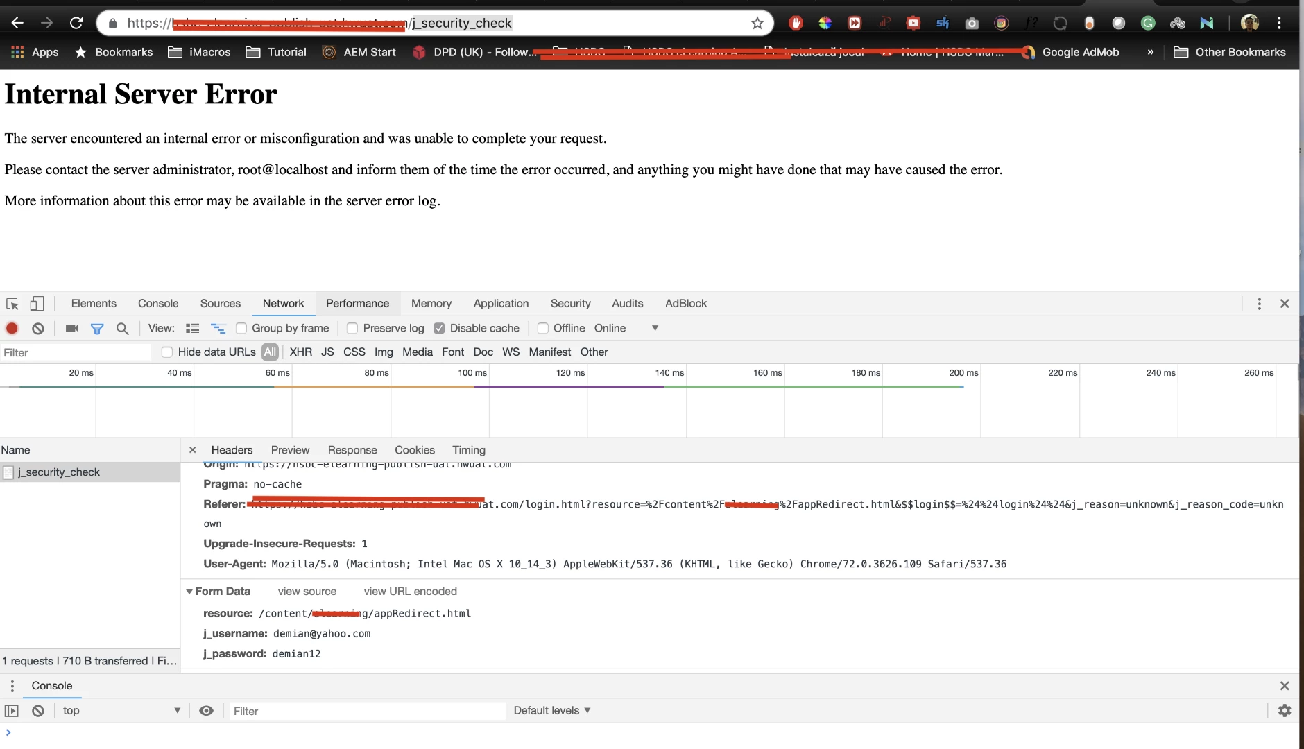

Hi guys, I'm using AEM 6.4 in which I've set up a login page. On the server we have a dispatcher configured and I confirm that without the dispatcher everything it's working alright. When I'm doing that post request to the j_security_check I get as a response an Internal Server Error.
I'm out of ideas with this. I mention, if I make the request bypassing the dispatcher, everything works.
I've also set the
/0099 { /type "allow" /global "*j_security_check*" }

Can you share any details about the message in the AEM error.log, when you do the post via dispatcher? Is the request in question reaching AEM at all (check the request.log)?
The error message you posted looks like an Apache error message, and not coming from Sling. it could be that's it is originating from Apache itself (mis-configuration? you might also check apache's error.log or the dispatcher log file) or it is masking an internal server error it received from AEM. I guess that's the very first step you need to do to understand the issue.
