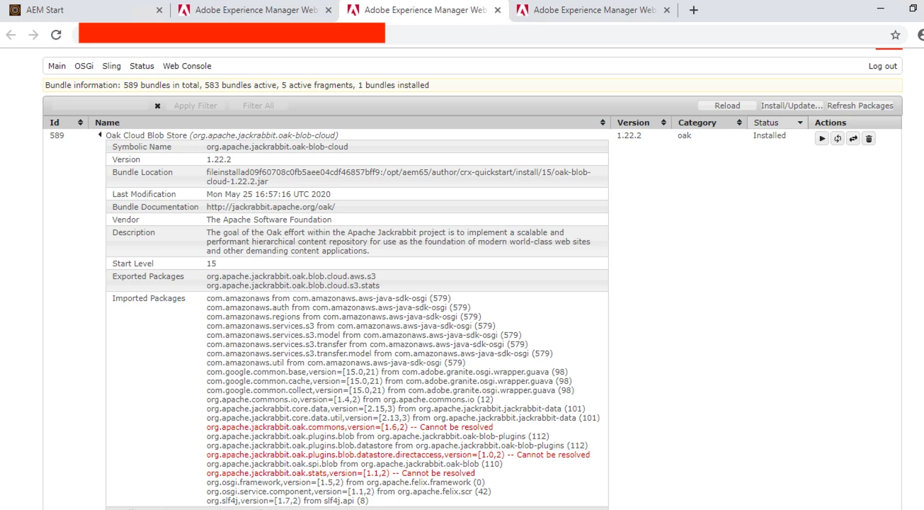

When the instance is started I can see this error at error.log file:
25.05.2020 16:57:31.772 *ERROR* [FelixDispatchQueue] org.apache.jackrabbit.oak-blob-cloud FrameworkEvent ERROR (org.osgi.framework.BundleException: Unable to resolve org.apache.jackrabbit.oak-blob-cloud [589](R 589.0): missing requirement [org.apache.jackrabbit.oak-blob-cloud [589](R 589.0)] osgi.wiring.package; (&(osgi.wiring.package=org.apache.jackrabbit.oak.commons)(version>=1.6.0)(!(version>=2.0.0))) Unresolved requirements: [[org.apache.jackrabbit.oak-blob-cloud [589](R 589.0)] osgi.wiring.package; (&(osgi.wiring.package=org.apache.jackrabbit.oak.commons)(version>=1.6.0)(!(version>=2.0.0)))])

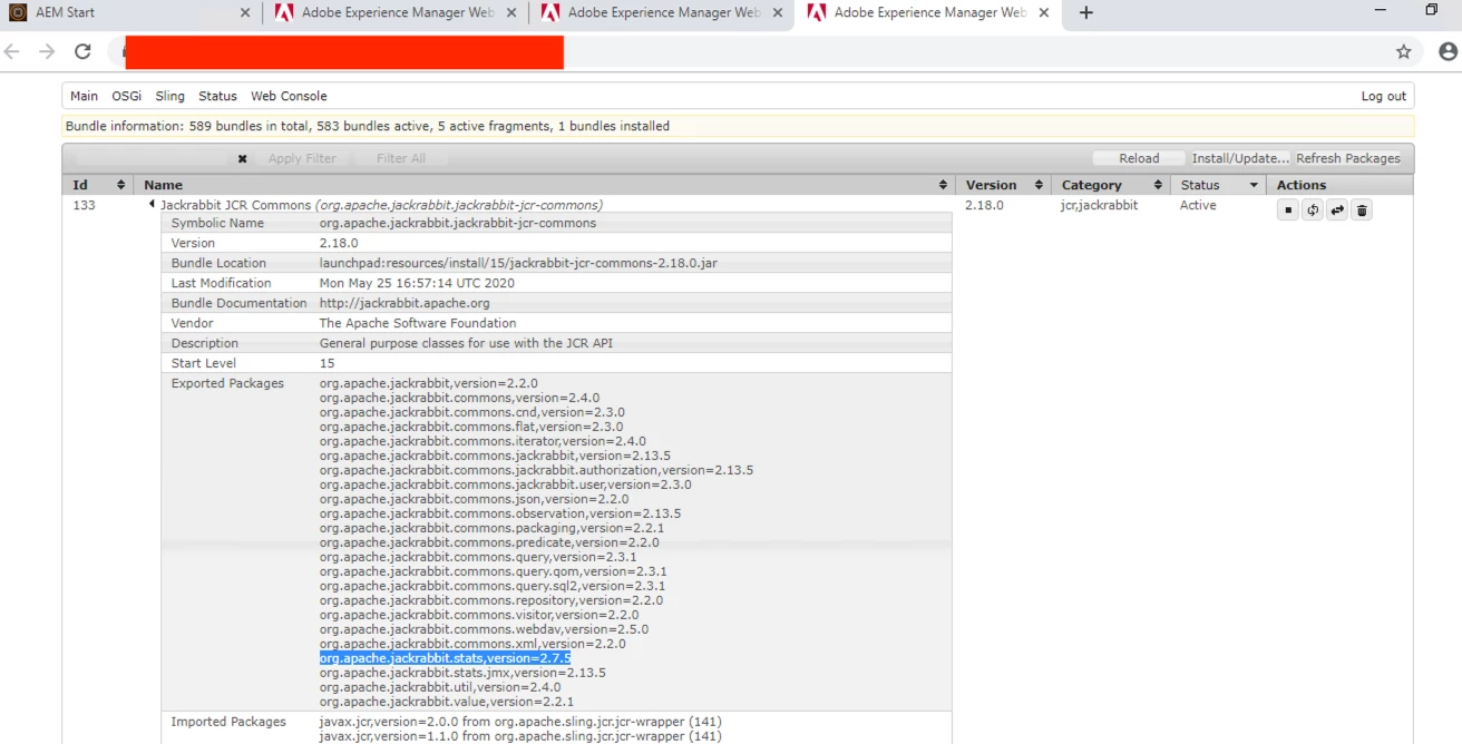

That can be visible at Felix Console:
But one dependency it cannot resolve is clearly installed and activated:
And if I try to refresh dependencies it does nothing…

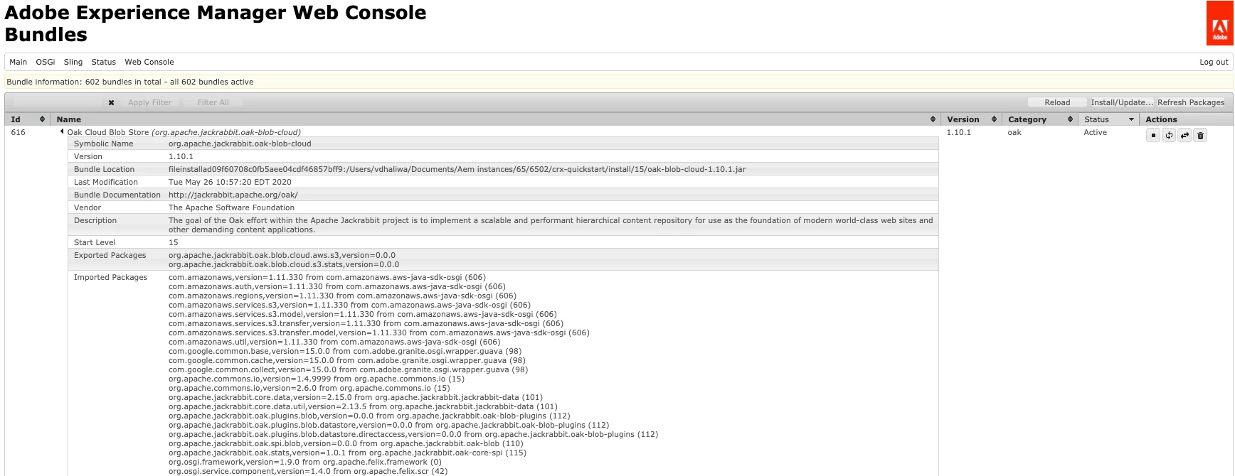

With 1.10.0 there is an activation but with errors also.
At error.log I can see this message:
25.05.2020 16:33:20.670 *INFO* [FelixStartLevel] org.apache.jackrabbit.oak-blob-cloud Service [org.apache.jackrabbit.oak.blob.cloud.s3.S3DataStore,815, [org.apache.jackrabbit.oak.spi.blob.BlobStore, org.apache.jackrabbit.oak.spi.blob.GarbageCollectableBlobStore, org.apache.jackrabbit.oak.api.blob.BlobAccessProvider]] ServiceEvent REGISTERED
25.05.2020 16:33:20.671 *ERROR* [FelixStartLevel] org.apache.aries.jmx.whiteboard.MBeanHolder register: Failure registering MBean org.apache.jackrabbit.oak.plugins.blob.BlobStoreStats@445351d
javax.management.InstanceAlreadyExistsException: org.apache.jackrabbit.oak:name=DataStoreBlobStore,type=BlobStoreStats
