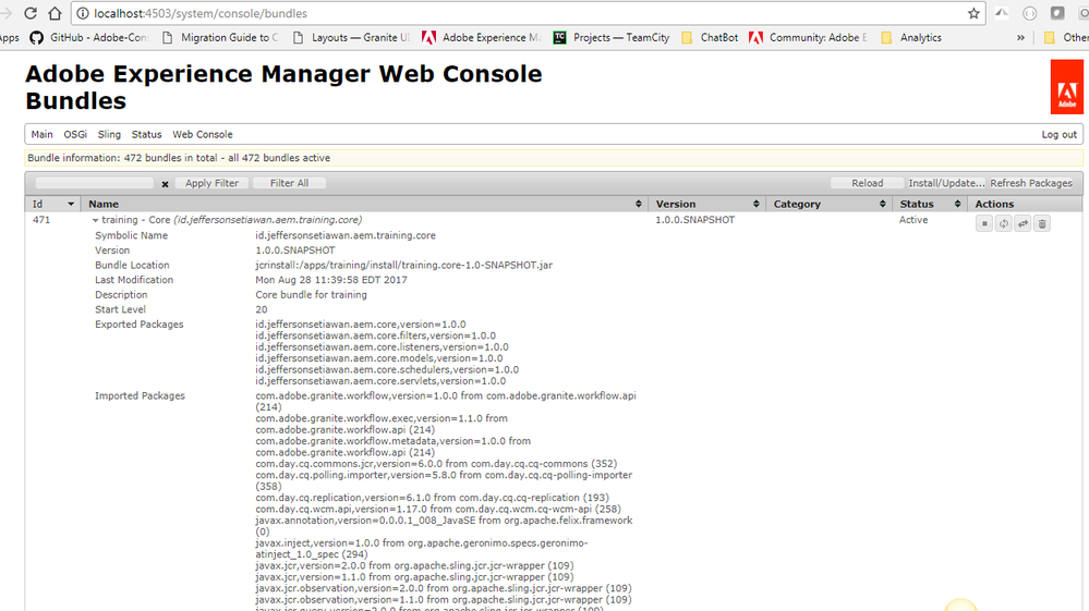

Thanks for reply @veena_07, here is my code GitHub - jeffersonsetiawan/demo-aem
VeenaVikraman
August 28, 2017
Hi Jeff
    I downloaded the package , built it using mvn clean install -P autoInstallPackage and replicated the same to publish. I can see the bundles installed and active in publish . Do you think there is any issue with your publish ? Do you want to try it in a new publish server ?
