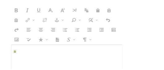

1>On using RTE to just have anchor link  by giving an label
2> latter on clicking source edit  shows an  empty.
We want to add in rte anchor tag like
<a id="test"> </a>  ,
Note:- Here the title is empty for the anchor link and not getting allowed by RTE
The use case we would want just a anchor link with some custom code added to it without any title.

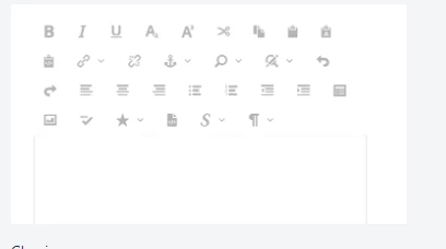

Issue is  on submitting the dialog and on re-opening does not have the anchor link. Touch UI anchor icon added with a label:-
Source edit clicked and turned off:-
Please let me know as how this could be solved
Best answer by Nirmal_Jose
Once you re-open the dialog and see that the anchor tag is no more appearing, is the <a id="someid"></a> visible on source editor view or that is trimmed off. If its trimmed off, mostly link checker might be removing a bad link. Please follow [1] to disable link checker as a whole or for a single use case.
[1] - https://helpx.adobe.com/in/experience-manager/kb/how-to-configure-linkchecker-tomark-alllinks-asvalid.html
Nirmal_Jose
Nirmal_JoseAdobe EmployeeAccepted solution
March 30, 2020
