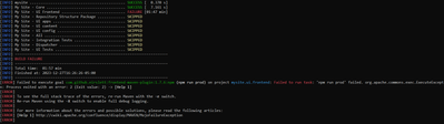

The previous error is solved but now i am getting the error in frontentend
[ERROR] Failed to execute goal com.github.eirslett:frontend-maven-plugin:1.7.6:npm (npm run prod) on project mysite.ui.frontend: Failed to run task: 'npm run prod' failed. org.apache.commons.exec.ExecuteException: Process exited with an error: 2 (Exit value: 2) -> [Help 1]
