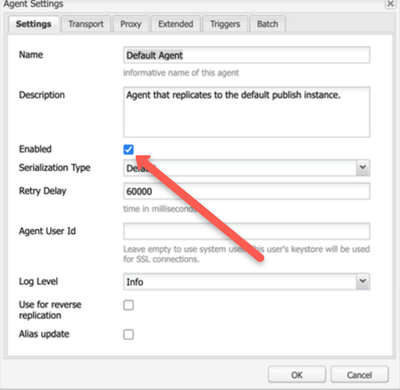

@TB3dock There is a filed called Enabled. Please select the check box.
Level 9
OK, I killed the publish instance (by force quitting java), and restarted it, now publication works! how do you publish the whole site? I only see the option to publish one page at a time?
