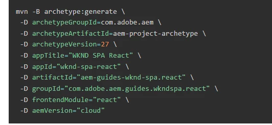

Yes both static and react component can co-exist but you need to have your project set up suport that.
For that purpose, you can always create your project using archtype with front end module as react.
https://experienceleague.adobe.com/docs/experience-manager-learn/getting-started-with-aem-headless/spa-editor/react/create-project.html?lang=en
