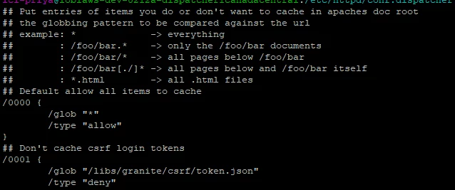

I can see the below configurations for cache in our dispatcher.  From what I understand it says to cache all pages.
How can I set my Akamai and dispatcher config to work in such a way that this request with a query parameter id is never cached? I read in documentation to use ignoreUrlParams  in this dispatcher configuration. If so, can someone help me with the rule to add both in dispatcher and Akamai level?

Hi @p_v_nair
Looks like you have enabled everything(based on above screenshot), you should deny access to all files and then allow access to specific areas. (whitelist pattern).
  /0001  { /glob "*" /type "deny" }
/0002  { /type "deny" /url "*.asp"  }

Hi @p_v_nair
First to disable cache at Dispatcher enable the cache rule for your servlet url in dispatcher.any under cache
/rules section.
example:
/0004
 /glob "/content/dam/test-code-reader*"
 /type "deny"
For Disabling cache in Akamai under the specific domain web property add a cache exclusion rule for the above mentioned url. then it will stop caching the servlet.
