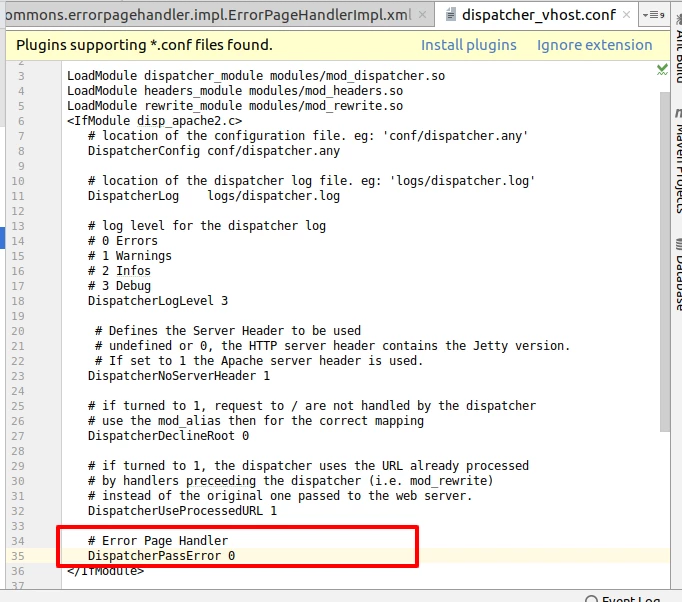

1. Check if the issue is from publish server or dispatcher. If issue is from dispatcher then ensure that you have done required AEM dispatcher configuration
 In dispatcher_vhost.conf file, set DispatcherPassError to ‘0’. This allows erring requests to be sent back to AEM.
