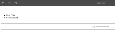

Now I create a page with 2 children:
And if I place the demo component on test-page, here is the result:
Hopefully that helps.
