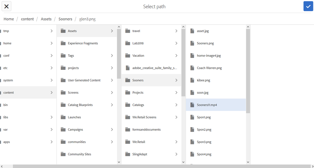

Most assets located in the DAM are used in AEM components. An author typically uses a component dialog - such as a PathFinder - shown here to select an asset.
This is a typical usage of Assets and use in AEM components.
