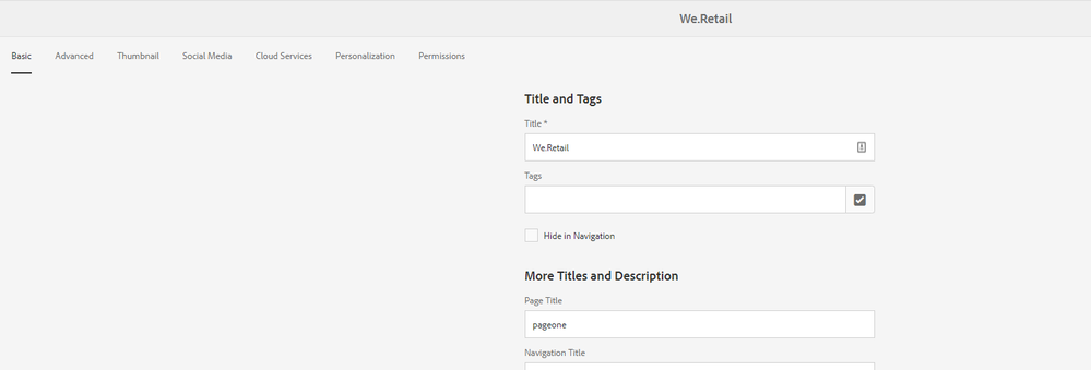

I also thought of the same thing but I need to create a dialog for site level configuration. I noticed that in AEM 6.4 the We Retail site uses a different page properties dialog at the top level We Retail page and a different dialog for the child pages. The child page dialogs inherits values from the parent page and we are able to cancel inheritance from parent dialog. I need to do something like this and my site level and page level dialogs have different tabs and fields too.
The above is the We Retail page properties dialog. Directly under this page are the country pages (us, ca, ch, de etc.) and these pages also have the same dialog with no inheritance.

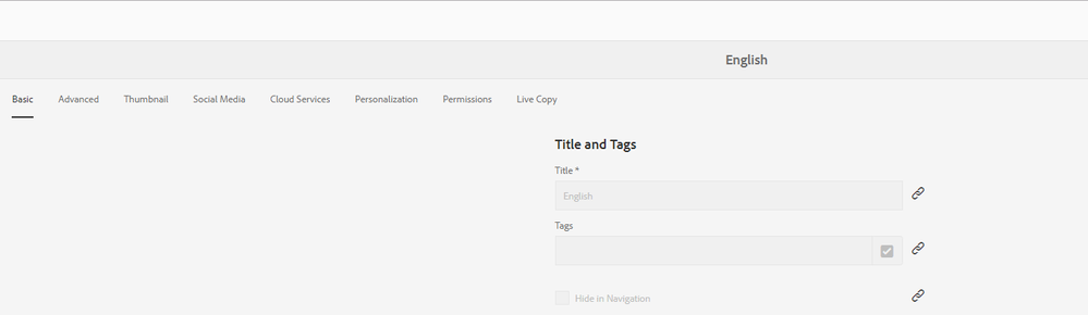

The above dialog is from the language pages onward. They have an extra tab called "Live Copy" which means somewhere a new tab has been added to the page properties dialog, which makes it a different dialog from the site level page properties, and also author can cancel inheritance for individual fields.
