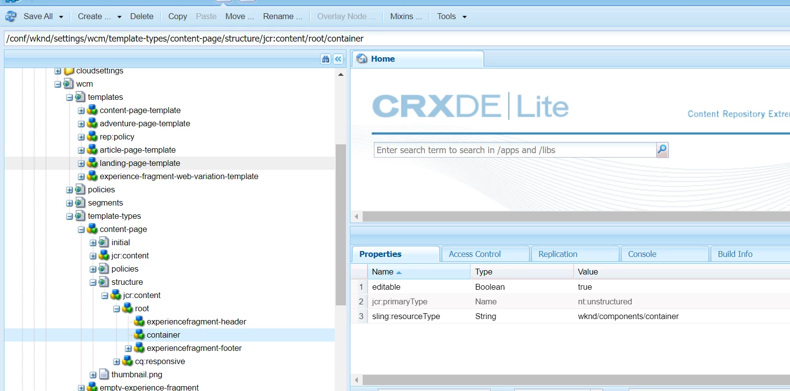

Best answer by aanchal-sikka
@monish_gavali
The Images are really burry for me. I am unable to understand the structure you have.
Requesting you to please refer to WKND templates and template-type. For a root container, you need to have "/structure/jcr:content/root" as indicated in the image below:

@monish_gavali
