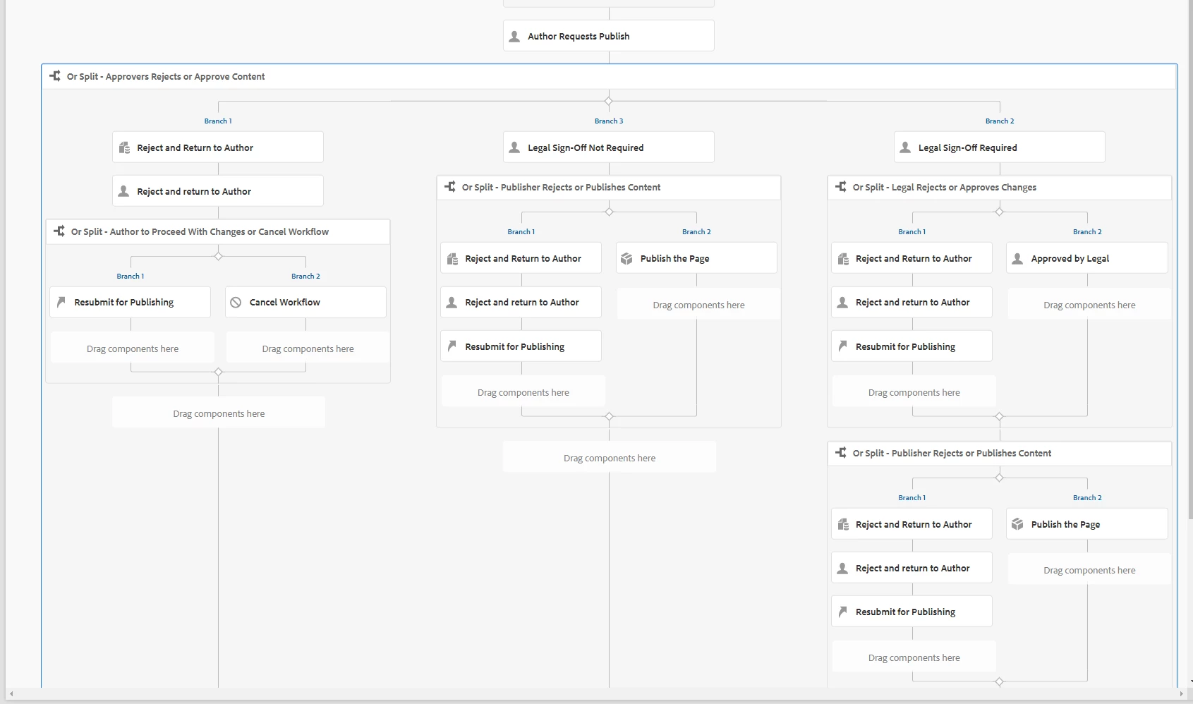

I am just wanting to create a basic approval workflow. I noticed a blog post re. conditional loop but I don't quite understand the process.
All I want is for when a change is rejected it goes back to the author to make changes and then resubmit for approval/publishing
Here is the workflow I currently have. I don't think I have set the goto steps correctly so currently when I run the workflow they just close the workflow. I'm not sure what I need to do.
Any help would be greatly appreciated.
Kindest Regards,
Reece
Best answer by RooRue
Thanks Siva for the suggestion. It may have confused me more so I actually went back to the guide here and tried the loopcount method.. to my surprise i've got it working now with this setup.
This allows the author to submit for approval/publish, the approver to reject, submit to legal or skip to publishers and then the publishers can either reject or publish the page.
Thanks again for trying to help. Really appreciated.

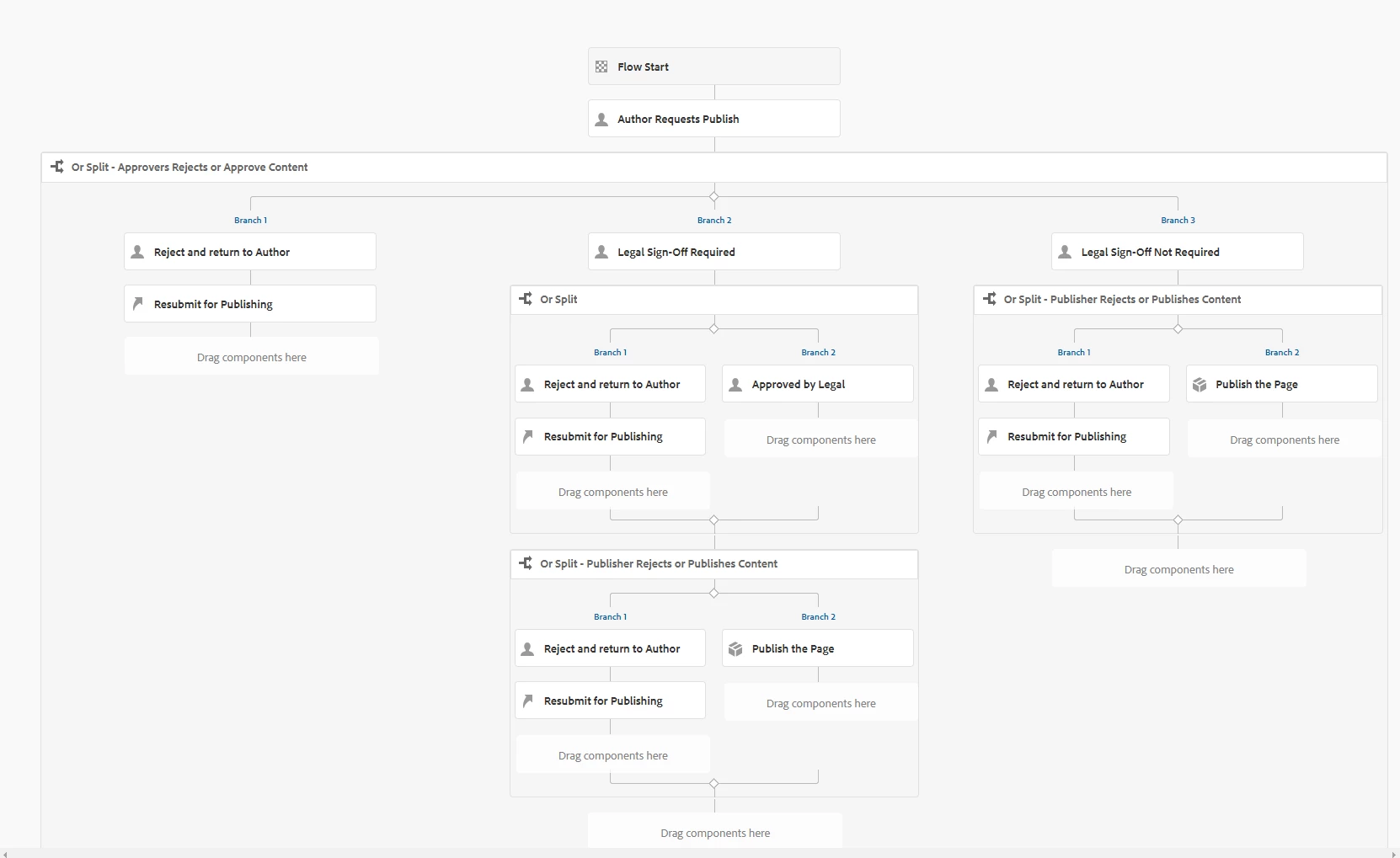

RooRueAuthorAccepted solution
May 1, 2023
