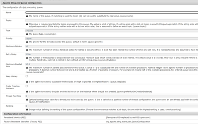

I am creating a utility to imports assets from FTP to AEm DAm server. For that I have used jobmanager.addJob("TOPICS","HASHMAP"); My job triggering withexact topic info and importing assets into AEM DAM Server.
To implement parallel execution of job Do I need to do anything apart from Apache Sling Job Queue configuration? If Yes then how to take care as there is not much documnetation on the Adobe documentation.
If any one implemented parallel jobs execution please provide inputs.
1. How to implement parallel execution of jobs. how to confirm that jobs executing parallelly by updating Apache Sling job Queue OSGI Configuration in AEM.
2. When Job is trigered it automatically processing JobResults and stopping reqest from there itselft.How to redirect request from JobConsumer to Osgi Service.

You don't need to do anything to configure parallel job execution.
You just have to take care of parallel execution in your business logic, I meant multithreading.

April 22, 2020
You need to write an event listener and onEvent method write a logic using thread.

Please refer to this documentation, to have better understanding of the Queues: https://sling.apache.org/documentation/bundles/apache-sling-eventing-and-job-handling.html#queue-configurations
To assure that they are running in parallel:
  • you would have to register many jobs simultaneously
  • Use different param for each registration to help identify the run.
