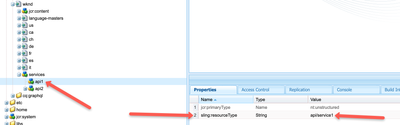

Anudeep_Garnepudi
Apr 27, 2021 8:22 AM UTC
@tb3dock
Registering Servlet using ResourceType:
I have a component Demo (/apps/ata/components/demo). Now am registering the Servlet with the resource type of my demo component.
import javax.servlet.Servlet; import org.apache.sling.api.SlingHttpServletRequest; import org.apache.sling.api.SlingHttpServletResponse; import org.apache.sling.api.servlets.HttpConstants; import org.apache.sling.api.servlets.SlingSafeMethodsServlet; import org.apache.sling.servlets.annotations.SlingServletResourceTypes; import org.osgi.service.component.annotations.Component; import org.osgi.service.component.propertytypes.ServiceDescription; @Component(service = { Servlet.class }) @SlingServletResourceTypes( resourceTypes="ata/components/demo", methods=HttpConstants.METHOD_GET, extensions="txt") @ServiceDescription("Demo Component ResourceType Servlet") public class DemoResourceTypeServlet extends SlingSafeMethodsServlet{ @Override public void doGet(SlingHttpServletRequest request, SlingHttpServletResponse response) { //Code } }
How to hit the servlet registered using ResourceType:
  • Drop the demo component in a page (ex: /content/en/us/test)
  • Copy the path till the demo component (ex: /content/en/us/test/_jcr_content/par/demo)
  • Here we registered with extension txt, so add txt extension to above path and hit (ex: /content/en/us/test/_jcr_content/par/demo.txt)
  • Request URL: /content/en/us/test/_jcr_content/par/demo.txt
Servlet can be registered using html and json extension as well. Refer: https://sling.apache.org/documentation/the-sling-engine/servlets.html#example-registration-by-resource-type-etc
