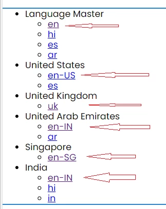

Hi Team,
I have created language navigation component extending aem core components, in order to achieve the region change functionality. For that I am trying to add my language navigation component in header component which is also calling Navigation.
But, I am not able to call.
1. please suggest which code I need to add the header.html to call this component.
2. Also, I need to call only English of all the regions which will be home page for all countries (NOTE: right now selected depth is 2). Please suggest how to achieve this.

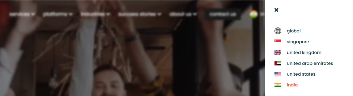

Required Functionality:

Hi @asutosh_jena_ @pawan-gupta
If I set the depth at 1 and select root from global page, it is showing pages url underneath the global (For India - IN, For US - US). However, I want English page from all the countries should be synched here (Eg: For India - en_in, US - en_us). How I can do that??

so, looking at your site structure now and assuming that it would grow based on country/language model OOTB way you can not achieve it because there will be parallel other language site will fall. you can just extend the core component and filter the result before display based on language (jcr:language, i hope you would be setting up) of the page. Also, if you decide to do that, you can extend further more by giving author an option of language in component dialog so that based on selected language the navigation will generate for that language only. I hope, it make sense!!
