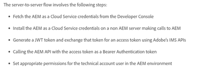

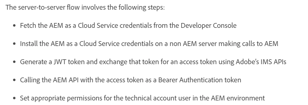

Thanks for your response. I think JWT seems looks in my case, as it involves system to system authentication. Do you have any reference on this works in AEM model java class?
Question - Seems every request hit publish to verify the access code and token code. Is this hit performance ? Can we manage this at dispatcher level ?
Sachin_Arora_
Sachin_Arora_Community AdvisorAccepted solution
August 2, 2022
Ideally there should not be performance hit but planning performance testing would give a clear picture. I don't think it can be controlled at dispatcher level as Authorization would be happening in AEM i.e. the last point mentioned in my previous comment screenshot.
