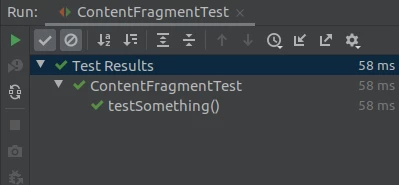

If you add these files to your project and run the test, you will be able to adapt the /content/dam/content-fragment to a ContentFragment and therefore pass the test 🙂

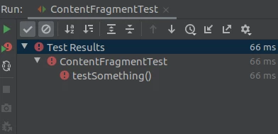

However, if you then delete the metadata node from the test JSON, the test will fail:
