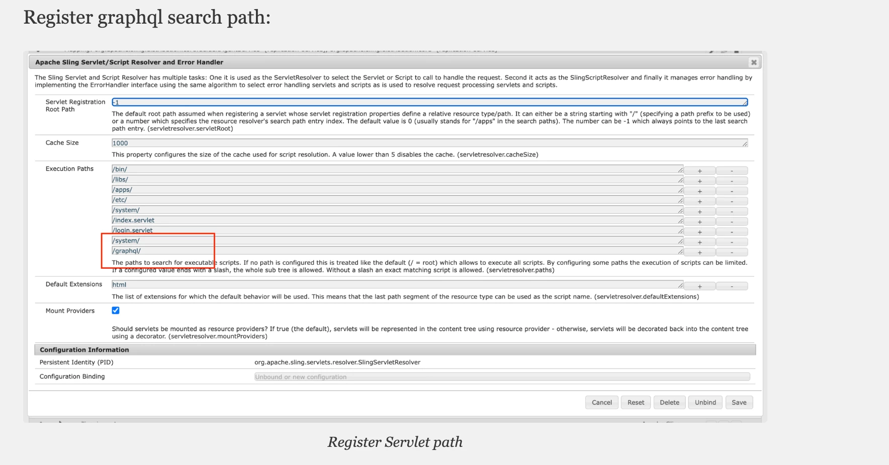

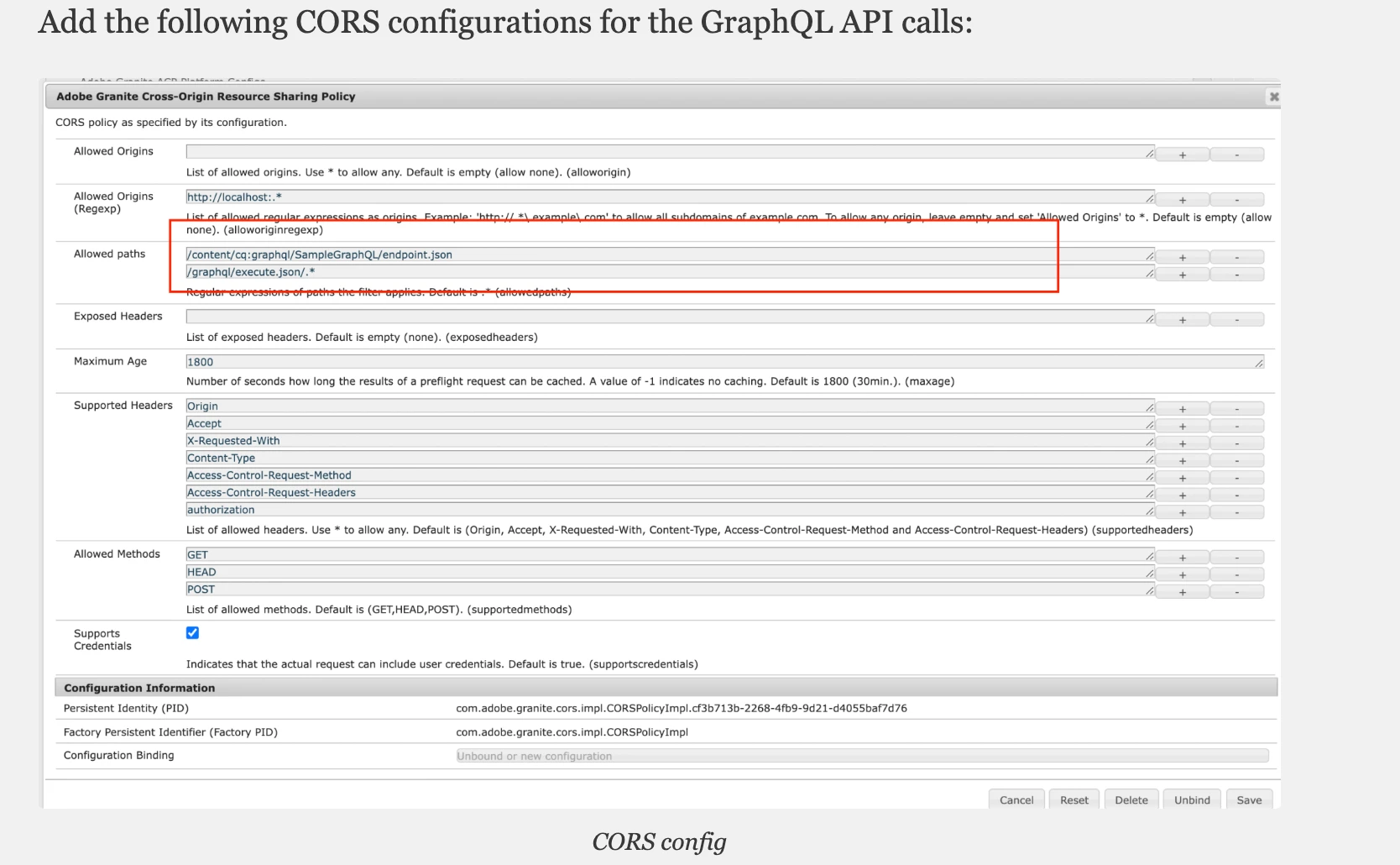

I have created a GraphQL endpoint on the author instance, and it works fine there. I’ve also published the GraphQL endpoint and the content fragment to the AEM publish instance. But when I try to access the GraphQL endpoint on the publish instance, I see the following errors.
AEM Version - AEM 6.5.17
{ "errors": [ { "errorType": "ServletError", "message": "Internal Servlet Failure", "details": "No suitable endpoint found." } ] }
I verified both Graphql and CF present on AEM publish instance. Also I enabled below two config as per https://statics.teams.cdn.office.net/evergreen-assets/safelinks/1/atp-safelinks.html
There is no error message on log file. Is there anything else I should check ?
