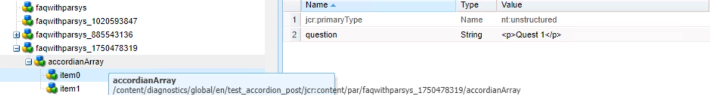

I am migrating an Accordion component. I have a multifield which has 2 fields
1. Question- cq/gui/components/authoring/dialog/richtext
2. id- granite/ui/components/coral/foundation/form/hidden

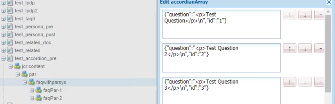

Before migration in the component properties both the fields are stored in JSON.
But after migration I see only question is getting stored in item nodes.
Any idea why only id is not getting stored after Coral 3 migration?

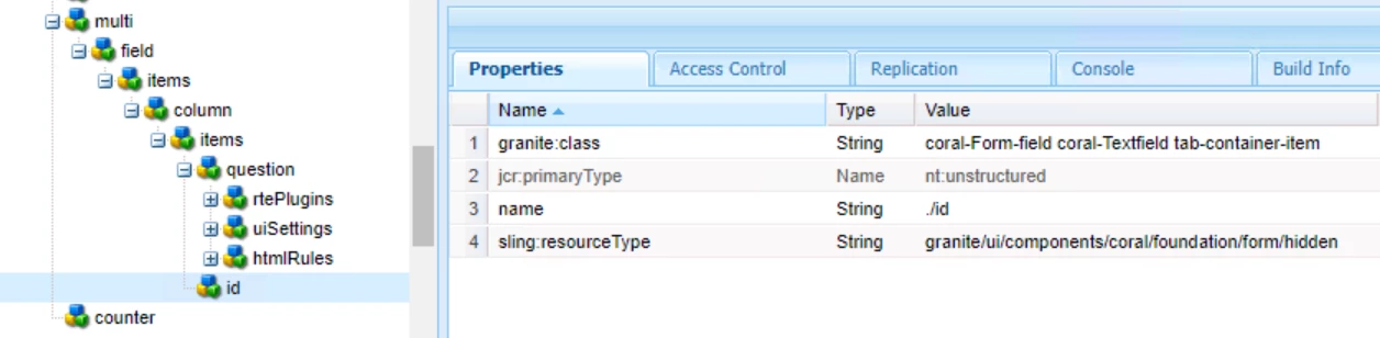

Hi @ks_hitijingole :
Could you please try giving "value" property as well to "granite/ui/components/coral/foundation/form/hidden" resource type.
without this property given value will not be saved in JCR.
check this documentation for more info :
https://helpx.adobe.com/experience-manager/6-5/sites/developing/using/reference-materials/granite-ui/api/jcr_root/libs/granite/ui/components/coral/foundation/form/hidden/index.html
July 9, 2021
@kirtia After adding value id is getting stored in item nodes. But earlier the id used to increment on it's own whenever a multifield was added. Same isn't happening now. Any idea how can it be implemented in Coral 3.

@bimmiso, After migration I believe the listener was not able to increment the value of ID. So I wrote a custom logic to add id in the Sling Model itself and I was able to achieve the expected behavior.
