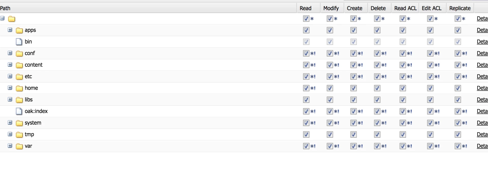

is your user capable to read the content areas, where the user is supposed to have read access to, and all nodes up to the root node? I've never faced your problem, but I could imagine, that internally some traversal is done, which requires these additional permissions.

Tuhin_Ghosh
Level 8
June 15, 2017
Hi Jörg Hoh
I have added all permissions just to make sure that its not the permission issue specific to my user. But no luck.
