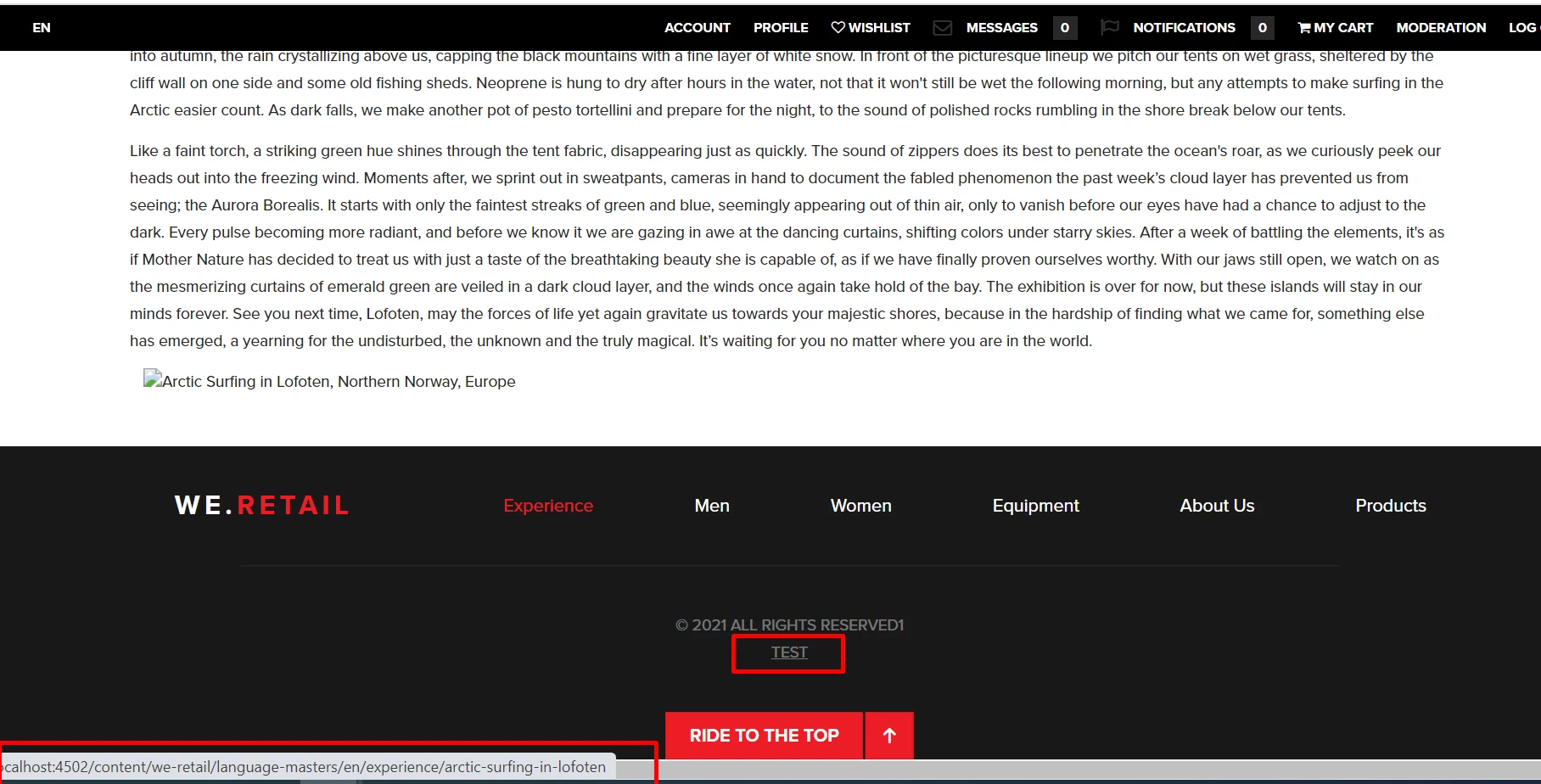

Etc/map rules only works when we add .html at the end of each url. Without .html, It does not map to appropriate url.

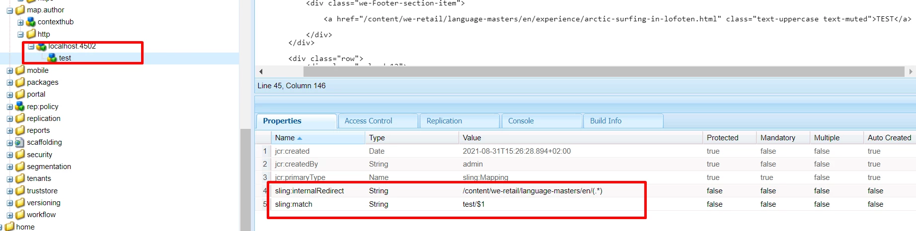

Below is etc/map :

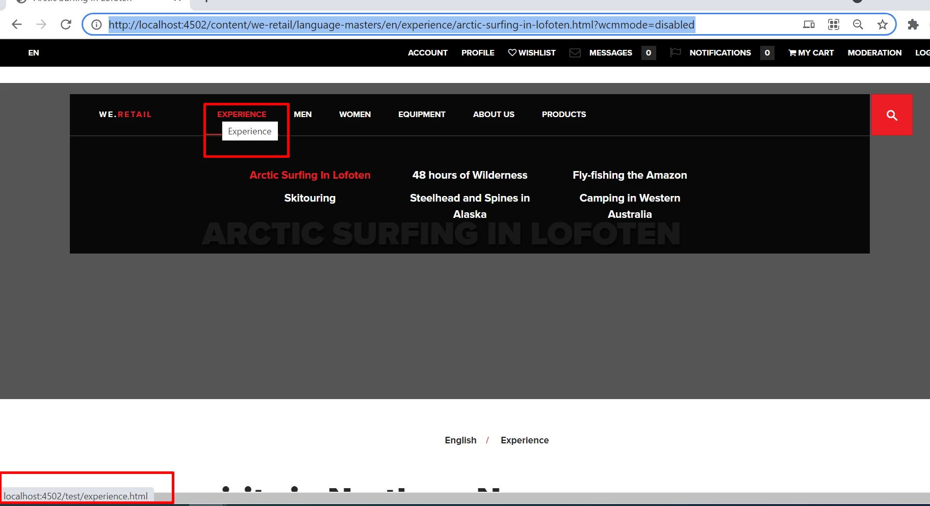

Now, when we access http://localhost:4502/content/we-retail/language-masters/en/experience/arctic-surfing-in-lofoten.html?wcmmode=disabled
Links are properly resolved like below:
PROBLEM:
When we remove .html from HTML files, It does not map to proper url as below:

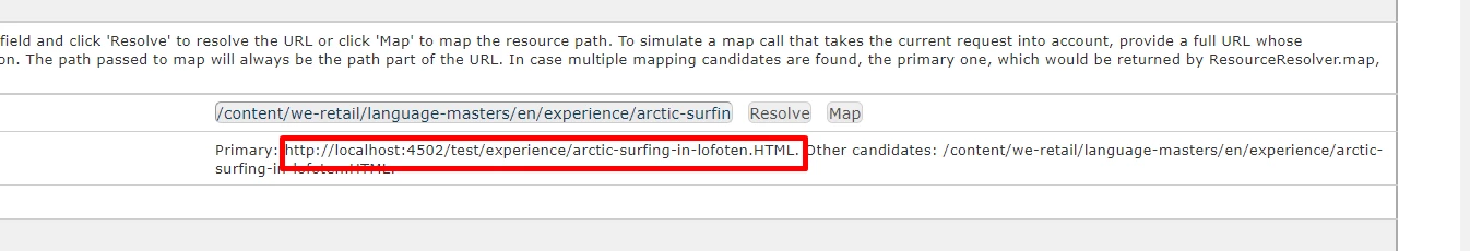

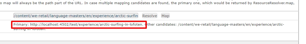

However,Through resource resolver It resolves in both the cases:
1) With .html:
2)Without .html

and ETC MAP Rules as below:
<jcr:root xmlns:sling="http://sling.apache.org/jcr/sling/1.0" xmlns:jcr="http://www.jcp.org/jcr/1.0"
jcr:primaryType="sling:Mapping"
sling:internalRedirect="[/content/we-retail/language-masters/en/(.*).html,/content/we-retail/language-masters/en(.*)]"
sling:match="$1"/>
Problem is :
It does not resolve URL without .html extension as below:
Idea is to have same output for TEST 1 also.
