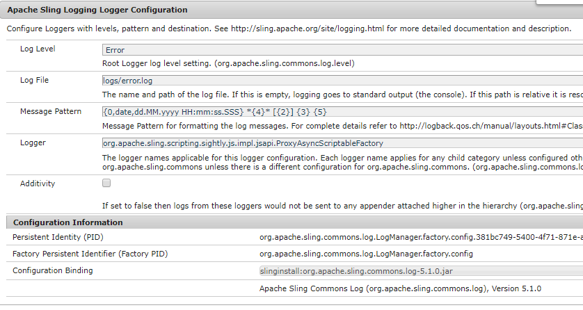

Dear All,
I have configured error.log in AEM console but still logs and not getting printed in the file
as below
But Still error.logs are not getting printed.
Is there a problem with this configuration or am i missing something?
Thanks in Adavance.
Naziya

Are you saying by default the "error.log" was not getting created ?
Can you see this logger in http://host:port/system/console/slinglog

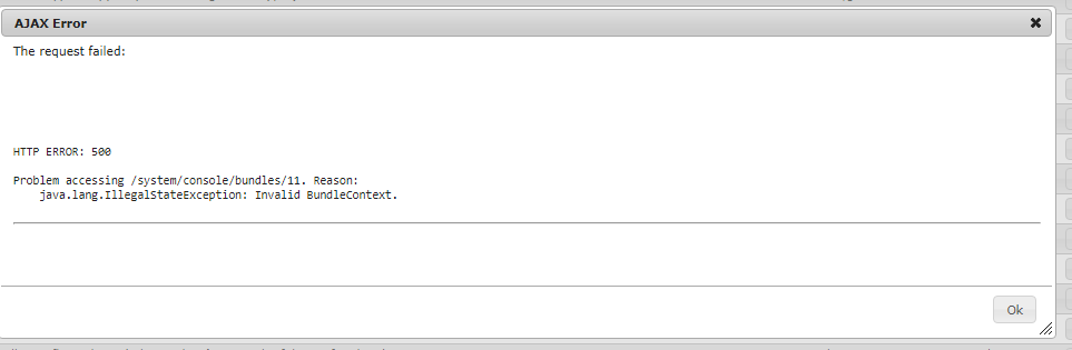

Can you go to http://<host>:<port>/system/console/bundles and restart the following bundles:
org.apache.sling.commons.logservice
com.adobe.granite.logging
com.adobe.granite.requests.logging
log4j.over.slf4j

Hi Hamid,
No they were generating and suddenly all logs stopped generating only stdout.log is generating rest all are not getting generated at all.
I have tried restarting server several times.

Hi Jaideep,
As suggested by i tried restating the bundles org.apache.sling.commons.log is not starting at all and printing following error in stdout.log file.
[ERROR] %bundles.pluginTitle: Cannot start
org.osgi.framework.BundleException: Activator start error in bundle org.apache.sling.commons.log [11].
        at org.apache.felix.framework.Felix.activateBundle(Felix.java:2290)
        at org.apache.felix.framework.Felix.startBundle(Felix.java:2146)
        at org.apache.felix.framework.BundleImpl.start(BundleImpl.java:998)
        at org.apache.felix.framework.BundleImpl.start(BundleImpl.java:984)
        at org.apache.felix.webconsole.internal.core.BundlesServlet.doPost(BundlesServlet.java:359)
        at javax.servlet.http.HttpServlet.service(HttpServlet.java:644)
        at javax.servlet.http.HttpServlet.service(HttpServlet.java:725)
        at org.apache.felix.webconsole.internal.servlet.OsgiManager.service(OsgiManager.java:563)
        at org.apache.felix.webconsole.internal.servlet.OsgiManager$3.run(OsgiManager.java:465)
        at java.security.AccessController.doPrivileged(Native Method)
        at org.apache.felix.webconsole.internal.servlet.OsgiManager.service(OsgiManager.java:461)
        at org.apache.felix.http.base.internal.handler.ServletHandler.handle(ServletHandler.java:120)
        at org.apache.felix.http.base.internal.dispatch.InvocationChain.doFilter(InvocationChain.java:86)
        at org.apache.sling.security.impl.ReferrerFilter.doFilter(ReferrerFilter.java:328)
        at org.apache.felix.http.base.internal.handler.FilterHandler.handle(FilterHandler.java:135)
        at org.apache.felix.http.base.internal.dispatch.InvocationChain.doFilter(InvocationChain.java:81)
        at com.adobe.granite.license.impl.LicenseCheckFilter.doFilter(LicenseCheckFilter.java:308)
        at org.apache.felix.http.sslfilter.internal.SslFilter.doFilter(SslFilter.java:96)
        at org.apache.sling.i18n.impl.I18NFilter.doFilter(I18NFilter.java:131)
        at org.apache.felix.http.base.internal.dispatch.Dispatcher$1.doFilter(Dispatcher.java:147)
        at org.apache.felix.http.base.internal.whiteboard.WhiteboardManager.invokePreprocessors(WhiteboardManager.java:1000)
        at org.apache.felix.http.base.internal.dispatch.Dispatcher.dispatch(Dispatcher.java:91)
        at org.apache.felix.http.base.internal.dispatch.DispatcherServlet.service(DispatcherServlet.java:49)
        at org.eclipse.jetty.servlet.ServletHolder.handle(ServletHolder.java:848)
        at org.eclipse.jetty.servlet.ServletHandler.doHandle(ServletHandler.java:584)
        at org.eclipse.jetty.server.session.SessionHandler.doHandle(SessionHandler.java:224)
        at org.eclipse.jetty.server.handler.ContextHandler.doHandle(ContextHandler.java:1180)
        at org.eclipse.jetty.servlet.ServletHandler.doScope(ServletHandler.java:512)
        at org.eclipse.jetty.server.session.SessionHandler.doScope(SessionHandler.java:185)
        at org.eclipse.jetty.server.handler.ContextHandler.doScope(ContextHandler.java:1112)
        at org.eclipse.jetty.server.handler.ScopedHandler.handle(ScopedHandler.java:141)
        at org.eclipse.jetty.server.handler.ContextHandlerCollection.handle(ContextHandlerCollection.java:213)
        at org.eclipse.jetty.server.handler.HandlerWrapper.handle(HandlerWrapper.java:134)
        at org.eclipse.jetty.server.Server.handle(Server.java:534)
        at org.eclipse.jetty.server.HttpChannel.handle(HttpChannel.java:333)
        at org.eclipse.jetty.server.HttpConnection.onFillable(HttpConnection.java:251)
        at org.eclipse.jetty.io.AbstractConnection$ReadCallback.succeeded(AbstractConnection.java:283)
        at org.eclipse.jetty.io.FillInterest.fillable(FillInterest.java:108)
        at org.eclipse.jetty.io.SelectChannelEndPoint$2.run(SelectChannelEndPoint.java:93)
        at org.eclipse.jetty.util.thread.strategy.ExecuteProduceConsume.executeProduceConsume(ExecuteProduceConsume.java:303)
        at org.eclipse.jetty.util.thread.strategy.ExecuteProduceConsume.produceConsume(ExecuteProduceConsume.java:148)
        at org.eclipse.jetty.util.thread.strategy.ExecuteProduceConsume.run(ExecuteProduceConsume.java:136)
        at org.eclipse.jetty.util.thread.QueuedThreadPool.runJob(QueuedThreadPool.java:671)
        at org.eclipse.jetty.util.thread.QueuedThreadPool$2.run(QueuedThreadPool.java:589)
        at java.lang.Thread.run(Thread.java:748)
Caused by: java.lang.NullPointerException
        at org.apache.sling.commons.log.logback.internal.LogbackManager$LoggerStateContext.<init>(LogbackManager.java:733)
        at org.apache.sling.commons.log.logback.internal.LogbackManager.determineLoggerState(LogbackManager.java:663)
        at org.apache.sling.commons.log.logback.internal.FilterTracker.getAppenderMap(FilterTracker.java:173)
        at org.apache.sling.commons.log.logback.internal.FilterTracker.addingService(FilterTracker.java:67)
        at org.osgi.util.tracker.ServiceTracker$Tracked.customizerAdding(ServiceTracker.java:941)
        at org.osgi.util.tracker.ServiceTracker$Tracked.customizerAdding(ServiceTracker.java:870)
        at org.osgi.util.tracker.AbstractTracked.trackAdding(AbstractTracked.java:256)
        at org.osgi.util.tracker.AbstractTracked.trackInitial(AbstractTracked.java:183)
        at org.osgi.util.tracker.ServiceTracker.open(ServiceTracker.java:318)
        at org.osgi.util.tracker.ServiceTracker.open(ServiceTracker.java:261)
        at org.apache.sling.commons.log.logback.internal.FilterTracker.<init>(FilterTracker.java:55)
        at org.apache.sling.commons.log.logback.internal.LogbackManager.<init>(LogbackManager.java:153)
        at org.apache.sling.commons.log.logback.internal.Activator.initializeLogbackManager(Activator.java:75)
        at org.apache.sling.commons.log.logback.internal.Activator.start(Activator.java:55)
        at org.apache.felix.framework.util.SecureAction.startActivator(SecureAction.java:697)
        at org.apache.felix.framework.Felix.activateBundle(Felix.java:2240)
And if I try refreshing its packages it gives below error
