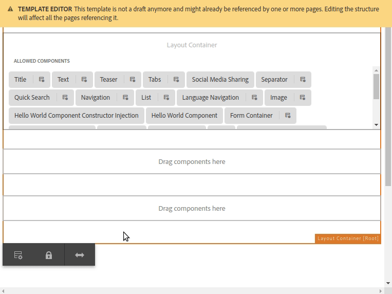

  1. The responsivegrid is locked.
    You can unlock it using the lock/unlock button like so:
  2. There are no allowed component. Make sure that the responsivegrid has a policy which allows a set of components to be placed inside.
    The responsivegrid should look like this in Structure mode:
    Not like this:
    Not like this:
