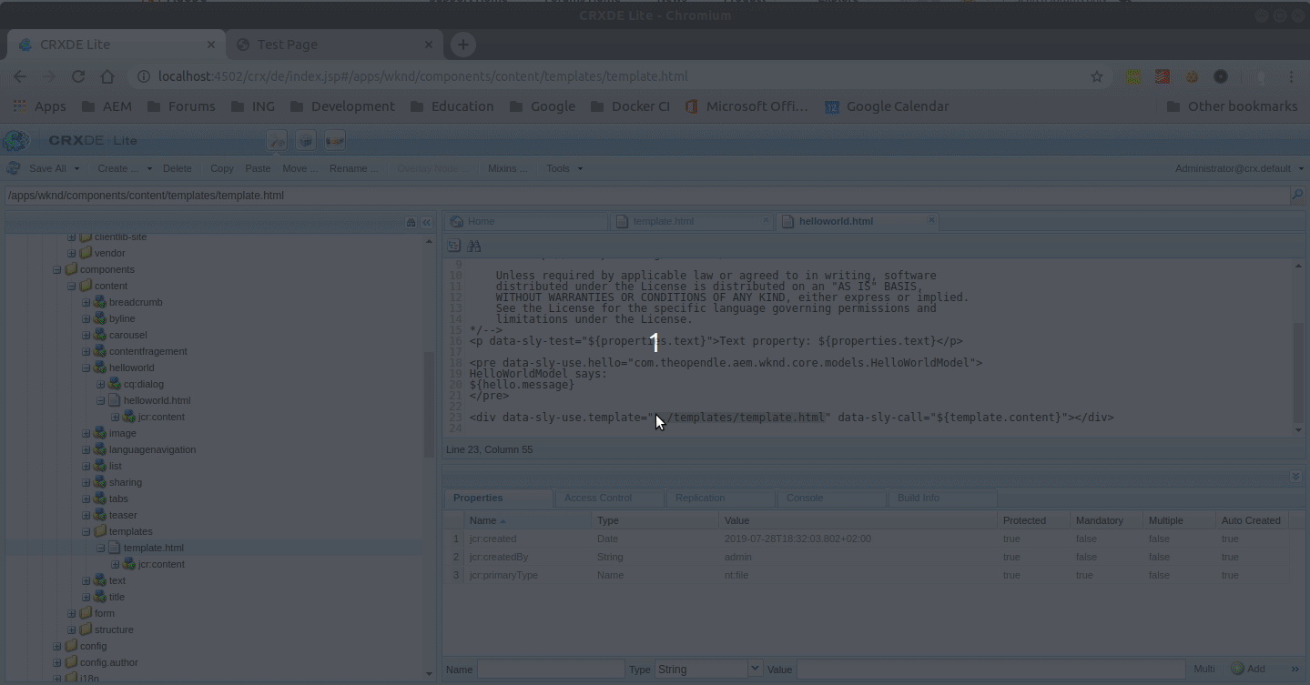

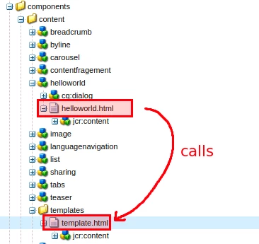

I reproduced it on my instance using this fix:
