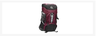

We are a new team using AEM and right now we're working on making Dynamic Media accommodate to our needs. One of the main issues we have found is that Dynamic Media does NOT crop images, but it re-sizes to cover as much of the rendition as possible, BUT always showing the whole image. This approach leaves big blank spaces which is a terrible user experience when browsing (see image below).
What Dynamic Media does
Has anyone encountered this issue? How have you solved it? We have thought of two options:
