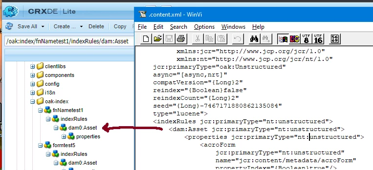

I am trying to use the Ensure Oak Index tool to create a new index. I created the new index from the index suggested by Oak Index Definition Generator. In the generated index, one of the JCR Nodes is named dam:Asset
Following the instructions for Ensure Oak Index, I am trying to deploy the index as code as a part of my build pipeline. Whenever I build the project, the node in my index is renamed from dam:Asset to dam0:Asset Can anyone tell me why? How can I deploy my index code via pipeline if I am not allowed to use that node name. The index does not work if the node is not named dam:Asset. On the right is the source .content.xml for my index. And on the left is what is being changed after during the package install. The built package is correct.

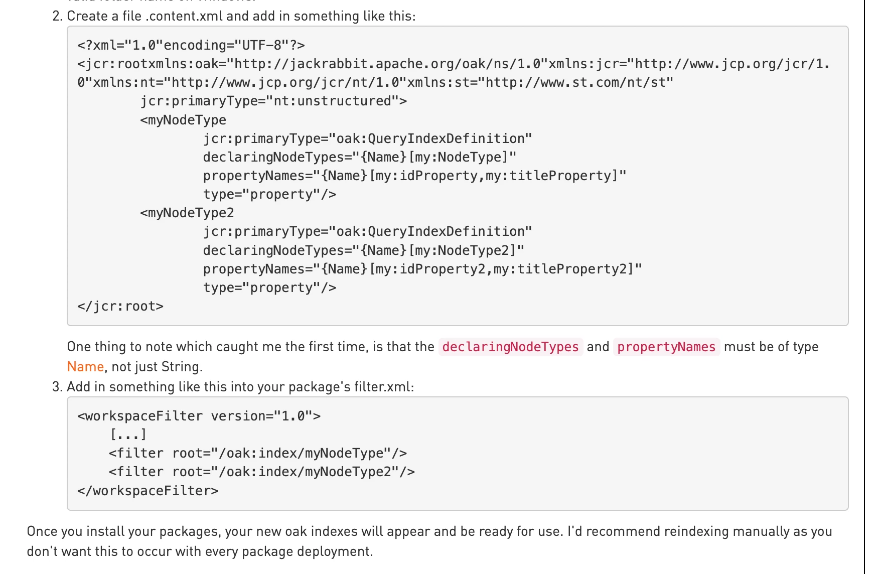

Hi @sxmalone,
Please check below points:
Reference article - http://www.6dglobal.com/blog/oak-index-packages-2015-03-09
Hi @sxmalone,
Thank you for the suggestion. It was not quite the right answer, but it did point me in the right direction. The problem and solution was the jcr:root node of my index:
<jcr:root xmlns:oak="http://jackrabbit.apache.org/oak/ns/1.0"
xmlns:jcr="http://www.jcp.org/jcr/1.0"
xmlns:nt="http://www.jcp.org/jcr/nt/1.0"
xmlns:dam="http://www.day.com/dam/1.0"
</jcr:root>
There was another object in our code repo that also was declaring a namespace for dam objects that used a different path "xmls:dam="https://www.jsp.org/jcr/dam/1.0" Once I made these two namespace declarations match, the system stopped renaming "dam:Asset" to "dam0:Asset".
