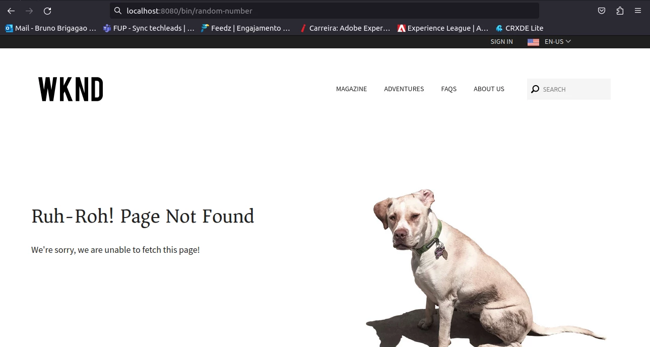

Well, I need to configure dispatcher so I can access a get servlet I've created. It works in author and publish instances. I've also already configured the dispatcher to run on port 8080 using docker and I'm able to access published content via port 8080. Nevertheless, when I try to access my servlet via this link: localhost:8080/bin/random-number it gives me this page with a 404 not found error when I check the browser console:
The linux command I'm using to run dispatcher on my project directory through docker is
sudo ~/aem-sdk/dispatcher/dispatcher-sdk-2.0.174/bin/docker_run.sh /home/webjump/estágio/trilha-04/aem-wknd-3.2.0/dispatcher/src host.docker.internal:4503 8080

Update: this is what I'm getting with the debug mode
[Tue Nov 28 15:01:00.932224 2023] [dispatcher:debug] [pid 313:tid 139849276103480] [client localhost:33972] Found farm publishfarm for localhost:8080 [Tue Nov 28 15:01:00.932247 2023] [dispatcher:debug] [pid 313:tid 139849276103480] [client localhost:33972] checking [/bin/random-number] [Tue Nov 28 15:01:00.932258 2023] [dispatcher:debug] [pid 313:tid 139849276103480] [client localhost:33972] request URL has no extension: /bin/random-number [Tue Nov 28 15:01:00.932262 2023] [dispatcher:debug] [pid 313:tid 139849276103480] [client localhost:33972] cache-action for [/bin/random-number]: NONE [Tue Nov 28 15:01:00.932313 2023] [dispatcher:debug] [pid 313:tid 139849276103480] [client localhost:33972] Filter rejects: GET /bin/random-number HTTP/1.1 [Tue Nov 28 15:01:00.932502 2023] [dispatcher:debug] [pid 313:tid 139849276103480] [client localhost:0] Found farm publishfarm for localhost:8080 [Tue Nov 28 15:01:00.932513 2023] [dispatcher:debug] [pid 313:tid 139849276103480] [client localhost:0] checking [/content/wknd/us/en/errors/404.html] [Tue Nov 28 15:01:00.932551 2023] [dispatcher:debug] [pid 313:tid 139849276103480] [client localhost:0] never flushed [/mnt/var/www/html/content/wknd/.stat] -> use cache [/mnt/var/www/html/content/wknd/us/en/errors/404.html] [Tue Nov 28 15:01:00.932564 2023] [dispatcher:debug] [pid 313:tid 139849276103480] [client localhost:0] cache-action for [/content/wknd/us/en/errors/404.html]: DELIVER [Tue Nov 28 15:01:00.932568 2023] [dispatcher:debug] [pid 313:tid 139849276103480] [client localhost:0] request declined [Tue Nov 28 15:01:00.932893 2023] [dispatcher:debug] [pid 313:tid 139849276103480] [client localhost:0] response.headers[Content-Type] = "text/html;charset=utf-8" [Tue Nov 28 15:01:00.932906 2023] [dispatcher:debug] [pid 313:tid 139849276103480] [client localhost:0] response.headers[X-Content-Type-Options] = "nosniff" [Tue Nov 28 15:01:00.932921 2023] [dispatcher:debug] [pid 313:tid 139849276103480] [client localhost:0] response.headers[Age] = "2937875" [Tue Nov 28 15:01:01.002473 2023] [dispatcher:debug] [pid 313:tid 139849276103480] [client localhost:33972] Found farm publishfarm for localhost:8080, referer: http://localhost:8080/bin/random-number [Tue Nov 28 15:01:01.002487 2023] [dispatcher:debug] [pid 313:tid 139849276103480] [client localhost:33972] checking [/etc/cloudsettings.kernel.js/conf/wknd/settings/cloudsettings/default/contexthub], referer: http://localhost:8080/bin/random-number [Tue Nov 28 15:01:01.002492 2023] [dispatcher:debug] [pid 313:tid 139849276103480] [client localhost:33972] request URL has no extension: /etc/cloudsettings.kernel.js/conf/wknd/settings/cloudsettings/default/contexthub, referer: http://localhost:8080/bin/random-number [Tue Nov 28 15:01:01.002496 2023] [dispatcher:debug] [pid 313:tid 139849276103480] [client localhost:33972] cache-action for [/etc/cloudsettings.kernel.js/conf/wknd/settings/cloudsettings/default/contexthub]: NONE, referer: http://localhost:8080/bin/random-number [Tue Nov 28 15:01:01.002626 2023] [dispatcher:debug] [pid 313:tid 139849276103480] [client localhost:33972] Creating new connection: 192.168.0.11:4503, referer: http://localhost:8080/bin/random-number [Tue Nov 28 15:01:01.002759 2023] [dispatcher:debug] [pid 313:tid 139849276103480] [client localhost:33972] Connected to backend 0 (192.168.0.11:4503), referer: http://localhost:8080/bin/random-number [Tue Nov 28 15:01:01.039008 2023] [dispatcher:debug] [pid 313:tid 139849276103480] [client localhost:33972] response.status = 200, referer: http://localhost:8080/bin/random-number [Tue Nov 28 15:01:01.039029 2023] [dispatcher:debug] [pid 313:tid 139849276103480] [client localhost:33972] response.headers[Date] = "Tue, 28 Nov 2023 15:01:01 GMT", referer: http://localhost:8080/bin/random-number [Tue Nov 28 15:01:01.039036 2023] [dispatcher:debug] [pid 313:tid 139849276103480] [client localhost:33972] response.headers[X-Content-Type-Options] = "nosniff", referer: http://localhost:8080/bin/random-number [Tue Nov 28 15:01:01.039041 2023] [dispatcher:debug] [pid 313:tid 139849276103480] [client localhost:33972] response.headers[X-Frame-Options] = "SAMEORIGIN", referer: http://localhost:8080/bin/random-number [Tue Nov 28 15:01:01.039046 2023] [dispatcher:debug] [pid 313:tid 139849276103480] [client localhost:33972] response.headers[ETag] = ""67400b98d9aa58b9970dc399607ec85102e979a6"", referer: http://localhost:8080/bin/random-number [Tue Nov 28 15:01:01.039051 2023] [dispatcher:debug] [pid 313:tid 139849276103480] [client localhost:33972] response.headers[Content-Type] = "application/javascript; charset=utf-8", referer: http://localhost:8080/bin/random-number [Tue Nov 28 15:01:01.049161 2023] [dispatcher:debug] [pid 313:tid 139849276103480] [client localhost:33972] No socket reuse: backend asks to close connection, referer: http://localhost:8080/bin/random-number
 Now I can see that the filter is rejecting the request, even though I've modified filters.any to allow it. Did I modify the wrong file? Is the syntax wrong? Is it missing something?
Above log shows that one of filter is rejecting this path. I suspect your filters.any file is not loading in your dispatcher. Changes made on default_filter.any will never be picked up. How are you calling the filter.any file in your dispatcher setup?. Try setting up your custom farm for your site and then call your custom filters.any
I've found the problem. I've modified the filters.any file at the dispatcher installation folder, but not in the wknd project dispatcher directory. I'm sorry about that, I'm an intern and I'm not having as much help as I should (so I kind of need to figure things out on my own and adobe tutorials can be a little confusing or incomplete).
