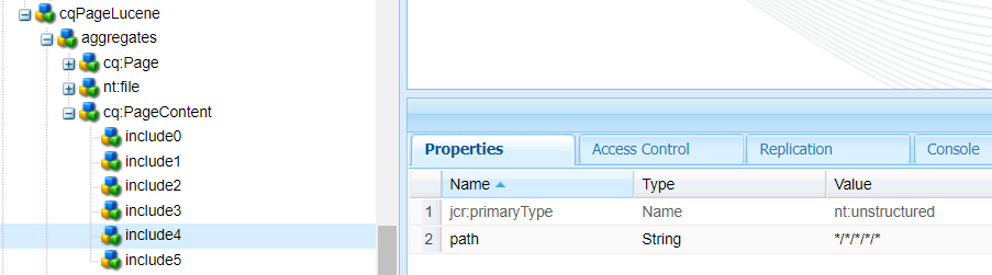

By default, the cqPageLucene oak:index only indexes 4 nodes deep (*/*/*/*).
To increase the node depth for search, you can add additional includes under oak:index/cqPageLucene/aggregates/cq:PageContent with additional levels. By adding include4 (*/*/*/*/*) and include 5 (*/*/*/*/*/*) to my aggregates, my nested components began producing search results.
