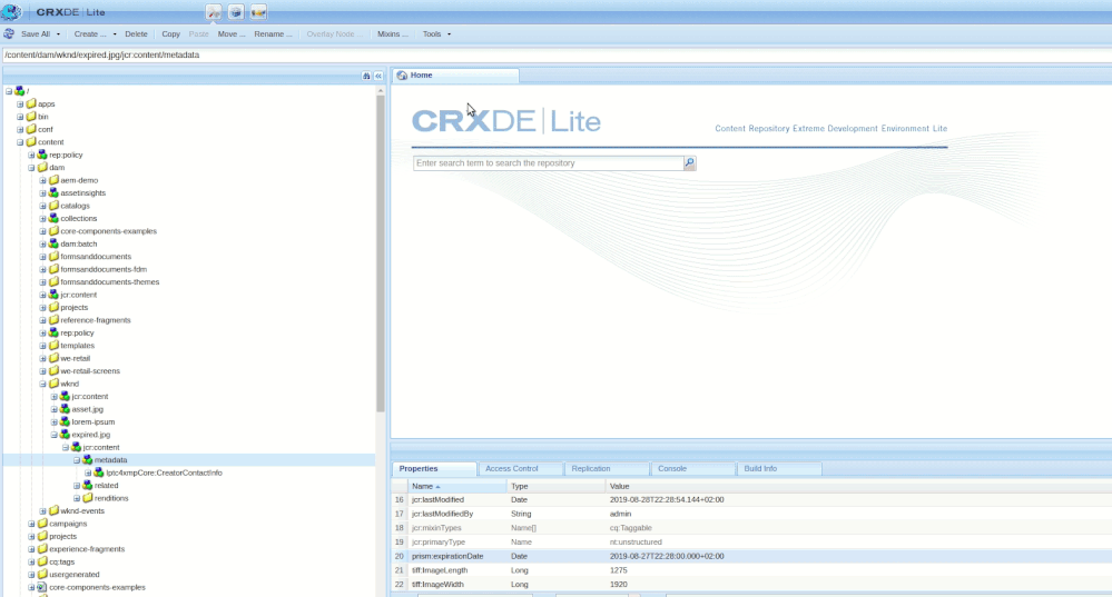

To delete the assets, you will have to create a workflow that finds all expired assets using a query, and deletes those nodes. Here is a query to find all assets expired at a given date (JCR SQL-2 does not have a DATE() function to get the current date, you will have to supply this date in Java):
SELECT asset.* FROM [dam:Asset] AS asset
INNER JOIN [dam:AssetContent] AS jcrContent ON ISCHILDNODE(jcrContent, asset)
INNER JOIN [nt:unstructured] as metadata ON ISCHILDNODE(metadata, jcrContent)
WHERE ISDESCENDANTNODE(asset, '/content/dam')
AND NAME(metadata) = 'metadata'
AND metadata.[prism:expirationDate] <= CAST('2019-08-28T23:59:59.999Z' AS DATE)
You can run this query now by going to CRXDE > Tools > Query, selecting SQL2, pasting the query in the text area and clicking execute:
August 28, 2019
