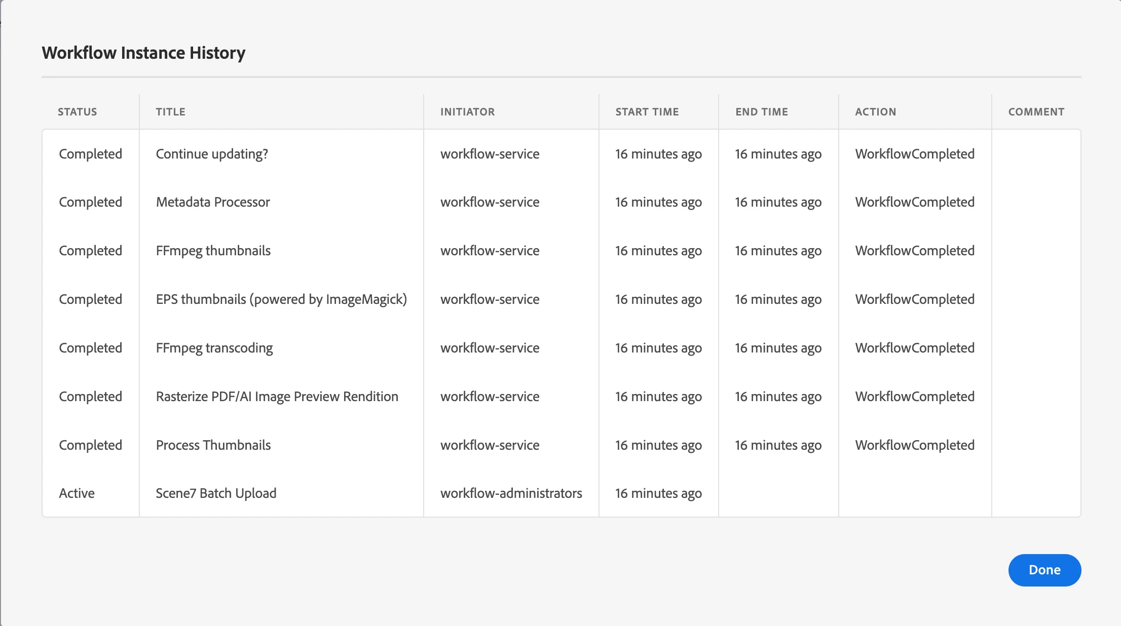

 i have been trying out the Dynamic media in my latest cloud SDK, i have created an image profile to a folder in dam and uploaded an image . But the image shows processing failed everytime and the workflow status shows always "Process Failed".
Workflow history is below

@kiran_22_12 check your scene7/dynamic media configuration.. appears that assets are not getting published to scene7 causing this
September 19, 2022
Thank you @nitin_laad , the configuration was used with pre-populated values and somehow that was causing issue that showed invalid username and password. I re-configured it by typing this time and it worked.

Please check the log file to get the exact root cause. There could be a connectivity issue between your server and Scene7. Please share logs to help you further.
September 19, 2022
Hi, @sachin_arora_ . these are the logs im getting

So the error is  "Failed to create a S7 IPS job". Try following things if it helps
  • Check Scene7 configuration if connection is still getting established.
  • Install  Dynamic Media Classic desktop application as you can see reason of failed job with details.
  • Create a log file set to debug level for following packages : com.adobe.cq.dam.ips & com.day.cq.dam.scene7. Please share logs if you find something useful apart from screenshot error.
  • Try with other images as well, sometimes corrupted image causes issue.
Last option is to raise a support ticket in Adobe.
