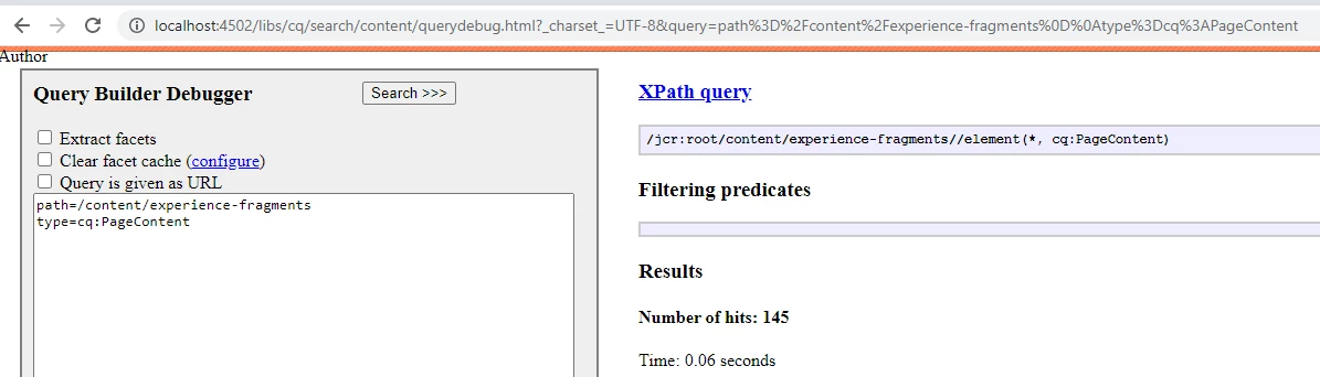

As a first step, can you try to execute the below query predicate set in querydebug.html(http://localhost:4502/libs/cq/search/content/querydebug.html) and also in Explain Query (Tools -> Operations -> Diagnosis -> Query Performance)
path=/content/experience-fragments type=cq:PageContent p.limit=-1
 Still no clue, create a logger for following in Sling -> Log support in Felix console (http://localhost:4502/system/console/slinglog)-> Execute the query again and share the details from log

October 6, 2020
Thank you for the suggestion.
I tried above steps but still clueless. One more thing, it only does not work for under /content/experience-fragment folder.
So here is what is working and what is not:
select * from [cq:PageContent] as data WHERE ISDESCENDANTNODE(data,'/content/experience-fragments/') = no result
select * from [nt:unstructured] as data WHERE ISDESCENDANTNODE(data,'/content/experience-fragments/') = gives result
select * from [cq:PageContent] as data WHERE ISDESCENDANTNODE(data,'/content/') = gives result too
select * from [cq:PageContent] as data WHERE CONTAINS([cq:tags],"cm-travel:XFTYPE/FAMILYDEP") AND ISDESCENDANTNODE(data,'/content/experience-fragments') AND [sling:resourceType] = "core/wcm/components/page/v1/page" = this works as well

@mayukh007
Below query provides expected result on AEM 6.5, can you please check error log when this query returns no result for you & also if possible share some screenshot of no result.
