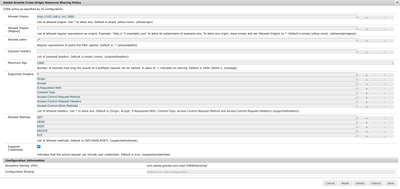

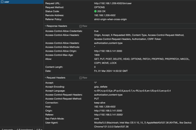

I'm working on a service that contains GET, PUT, POST, and DELETE methods. But faced issues with doPut method.
I configured
Added needed methods

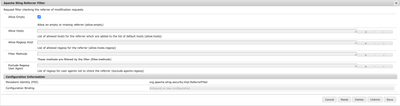

Removed from filter
Remove from the filter and allow empty

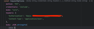

Sending request from ReactJS app

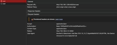

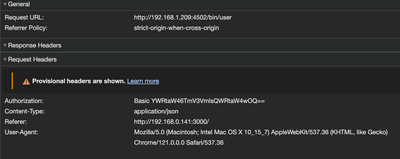

In browser, I see 2 requests

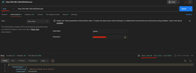

And this request doesn't work. But via POSTMAN PUT request works as expected. Where did I go wrong?

@aliaksandr_hvoz It must be access with the help of anonymous user in author with the help of Sling Authentication and for postman also.
Postman must be giving 401 error code while making call in response. To make a call via POSTMAN it will require authorization as show below:

I log in to Postpan.
I don’t want to use anonymous because it will lead to the fact that authorization will not be needed - it’s not safe.

The reason is that in your ReactJS app, it will first trigger a "preflight" request to ensure there are no CORS issues. This request is of type OPTIONS (this is missing in your 1st screenshoot). In contrast, Postman will avoid this and only execute the method (request) you are attempting to perform. To solve the problem, you would need to add the OPTIONS method to the "allowed methods" in the CORS configuration.

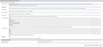

The request with OPTIONS returned with 200 status and PUT with CORS issue.
I added OPTIONS to "allowed methods".

can you please give the actual CORS error message - actual error message in the browser console
aliaksandr_hvoz
March 4, 2024
And so, from my observations.
As I understand it, this error occurs because I am accessing AEM from a React application from another machine (another IP).
How to solve this problem?
