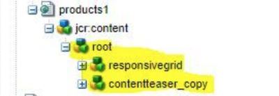

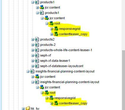

Hi, I'm encountering an issue wherein the generated experience fragment is being created not in the responsive grid instead it goes directly inside the root because the working converted experience fragments are all created inside the responsive grid. Please see the attached screenshot for reference.
Working XF is insights-financial-planning-content-layout while the failed XF conversion is products1.

By looking into the first example (products1) I can see you have added a Layout container on the page first and then Content Teaser componet after the Layout container not inside the layout container which is why you are getting the structure like below:
but for the second example (insights-financial-planning-content-layout) I can see you have added a Layout Container on the page first and then the Content Teaser component inside the Layout Container which is why you are getting the below structure:
In both the cases you should be able to see the content and should be able to render the content on the main page using the experience fragment component. It should not create any issue as both the structures are valid here.
