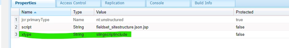

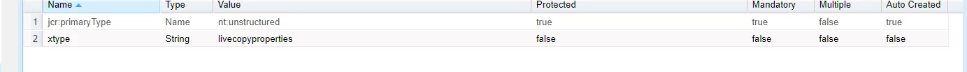

We are encountering one issue while component migration form coral to coral Ui 3.
we have some custom xtype properties in component which we are trying to convert to coral Ui3, but we see that custom xtype are not getting converted.
Please find the example below:
Custom Xtype:
These properties are not getting converted to sling:resourceType.
Any help would highly be appreciated.
