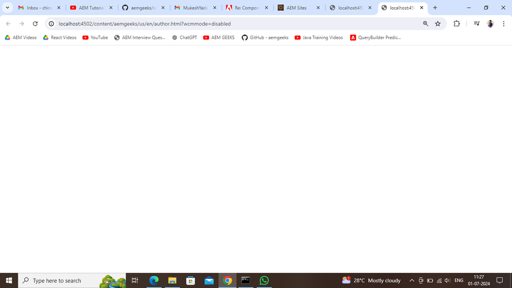

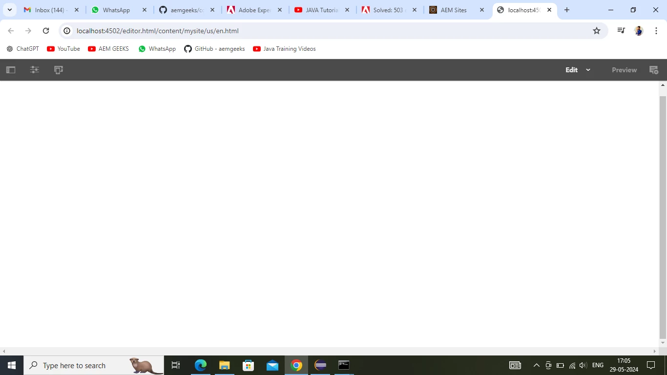

Hi Guys,
will you please help to solve this issue  I am not able to load the components and templates while build and deploy the code by using the maven command  please have a look at the below attached pic
Chinna.

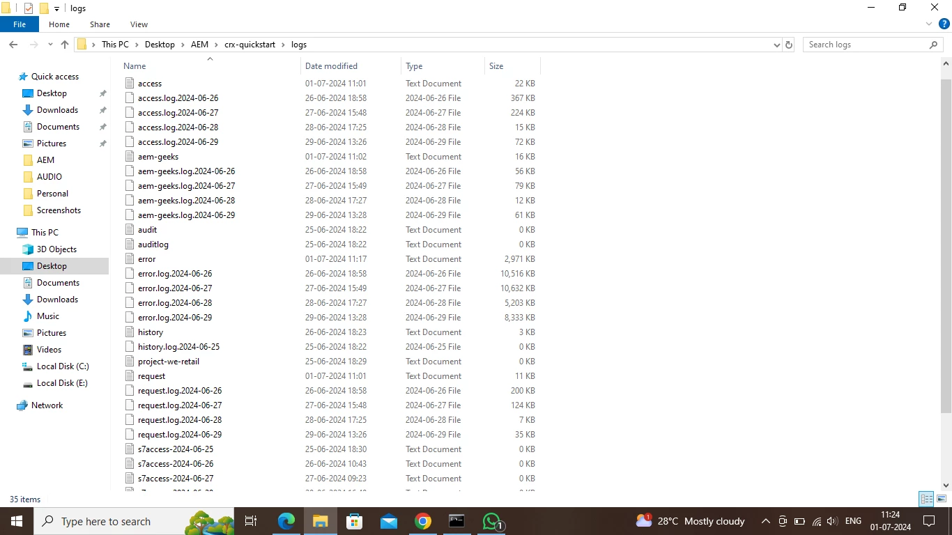

Hi @chinnama,
Can you please share the logs which are coming post reloading the page ?
ChinnaMaAuthor
July 1, 2024
These are the logs
July 1, 2024
Can you kindly open error.log and share the errors which you are getting.

Hi @chinnama ,
Do view as published most probably you will get error and accordingly debug.
ChinnaMaAuthor
July 1, 2024
I am following the instructions as you said   but its not coming  here is the pic please have look
