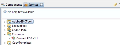

I have an AEM 6.3 instaltion and it's missing most of the Common services...
Someone else had this problem?
Thank you!

I noticed that this is stopped and when I try to stop I get this error:
