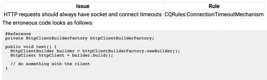

The code quality step for the Non-production pipeline threw the following error.
what is the correct code snippet to replace the above code.

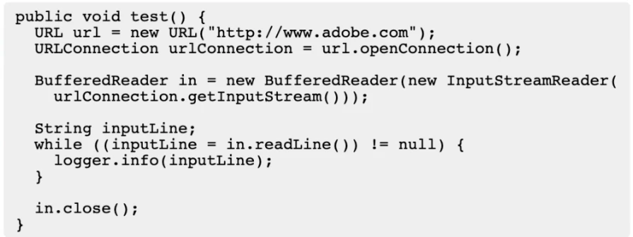

a.

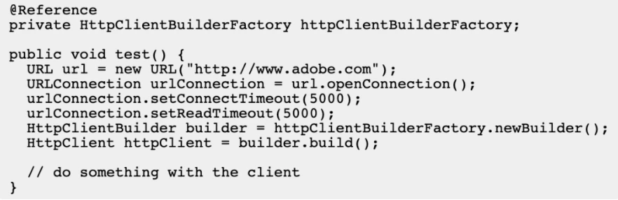

b.

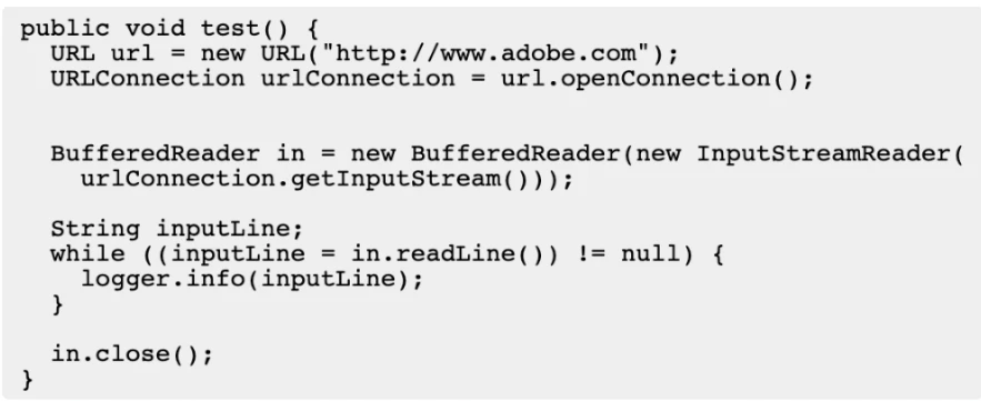

c.

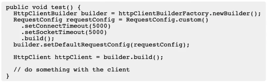

d.

Best answer by Mahedi_Sabuj
Option B
public void test() { HttpClientBuilder builder = httpClientBuilderFactory.newBuilder(); RequestConfig requestConfig = RequestConfig.custom() .setConnectTimeout(5000) .setSocketTimeout(5000) .build(); builder.setDefaultRequestConfig(requestConfig); HttpClient httpClient = builder.build(); // do something with the client }
Mahedi_Sabuj
Mahedi_SabujCommunity AdvisorAccepted solution
January 2, 2024
Option B

Thanks a lot.. This explains well
