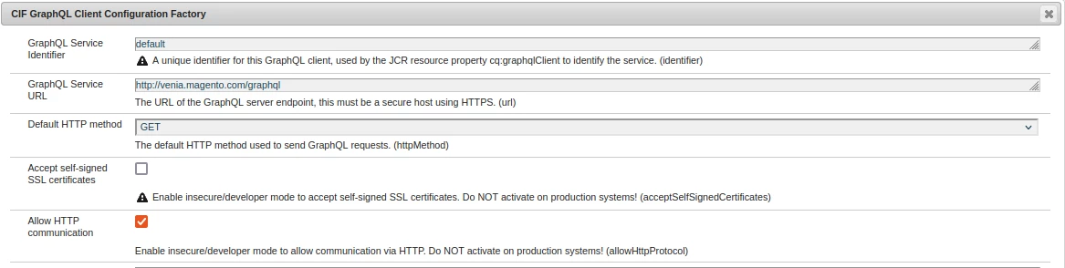

These are my Commerce endpoint details in osgi:
Is it wrong? I'm kind of lost in this task and not receiving the help I should from my work colleagues.
