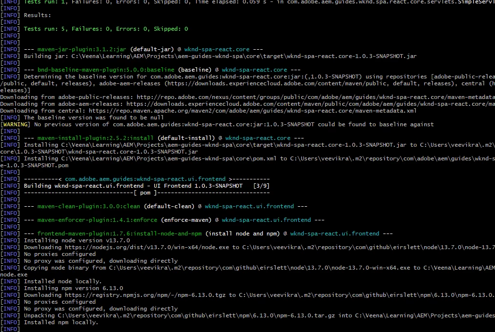

I tried the same in my local and I have below modules in my package
 Also I ran the build command in my git bash and all seems to be working fine
Can you recheck and let us know your steps you followed ?
