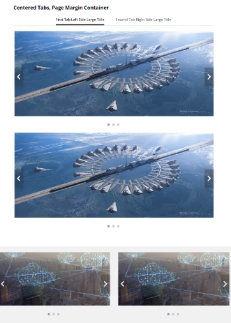

View page as published, and I see the two carousels working in the first tab.  No issues with id conflicts, or js conficts... the two carousels outside of the tabs are working as well.

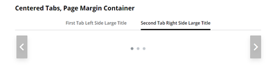

Tab TWO, the images of the carousel did not load.  But the controls of the carousel are there.  So the previous button, the next button and even the dots are there.  But not the images.

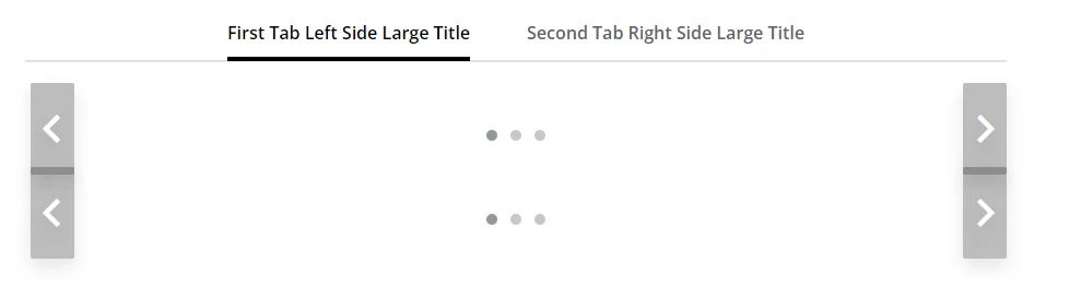

Now the first tab shows two carousels with no images, (the controls are there)

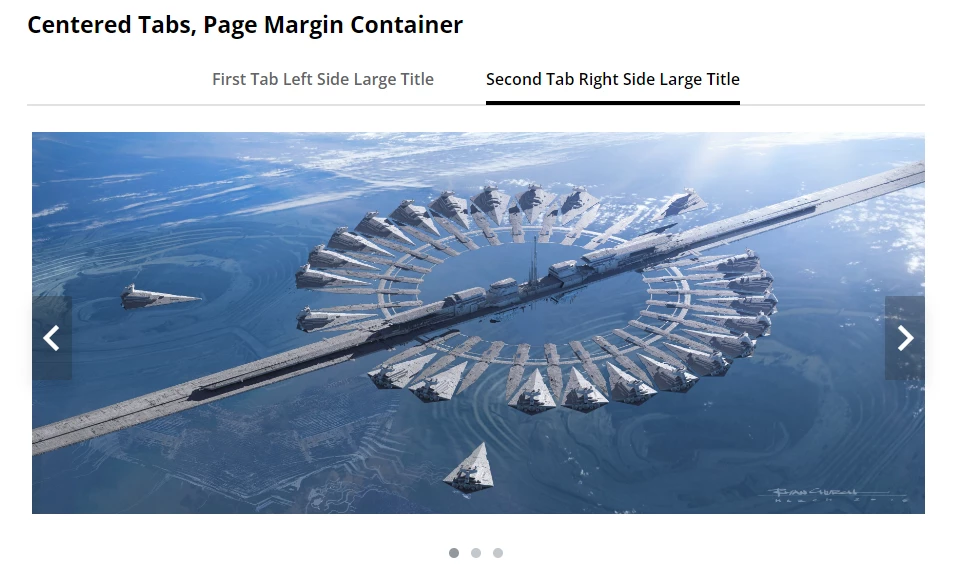

and the second tab has images.
