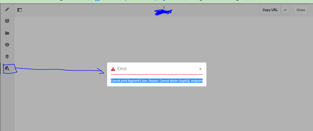

hello,
I have created a content fragment model and when i click the json view i am getting this error.
AEM version 6.5.12 nosample-content
while inspecting console errors are
Same model is working in my local only difference I observe is my local is having sample content but above is not
Nitin_laad
March 21, 2022
@amit_kumart9551 tried to reproduce the issue in my local 6.5.12 and AEMaaCS, able to generate JSON with no issues.
Try to enable graphQL endpoint as per below link and see if you can resolve your issue -
AEM GraphQL API for use with Content Fragments | Adobe Experience Manager
March 22, 2022
Thanks , my local is also working i am facing issue in production mode no sample content. I will check the article and try again.
After adding endpoint now getting "Cannot print fragment's Json. Reason: Cannot generate GraphQL query"
Ravi_Joshi
April 26, 2022
Hi @amit_kumart9551 ,
Try enabling a site-specific graphql endpoint configuration by using the below reference.
https://github.com/AdobeDocs/experience-manager-cloud-service.en/blob/main/help/headless/graphql-api/graphql-endpoint.md
Ravi
